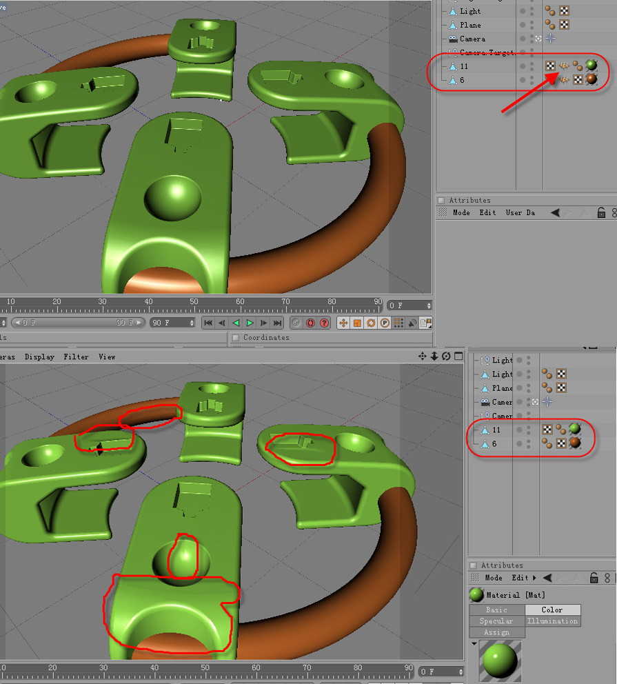

Hello everyone,
I am use C4D 10.11 and cindigo 1.0b2.
Now can't work, I don't know the problem come from where, have you already met such situation? hope can tell me right method.
Thank everyone.
--greeting & Good Luck
Intel i7-920,RAM 3G ,GeForce 9800GTX+.
Post by fused » Tue Dec 25, 2007 4:23 am
this happens if you have lots of unused points. use functions->optimize.
you seem to define the material of the inside of the cups more than once. you only have to denfine it once in a material tag somewhere in the scene and can use it as on any model you want.
nice to see that someone is actually using my exporter! :D

Post by Xman » Tue Dec 25, 2007 4:47 am
Hello fused,
Looks, BE my method problem perhaps, but I don't know how do is right.
This's a different scene in here, it owns a same problem.
please,you test it.
Thanks.........

Post by fused » Tue Dec 25, 2007 9:24 am
ok, i found the problem.
try deleting the normal-tag!

Post by Marcofly » Tue Dec 25, 2007 11:09 am
yes, the normals tag always gives this warning message, although i haven't noticed other than a longer warm-up..

Post by Xman » Tue Dec 25, 2007 8:58 pm
Thank you-all,
Fused, can you let the normal-tag and Cindigo cooperate work?
Because no this normal-tag model will the not smoothness.
merry Christmas and have nice day :D
Marcofly
Posts: 407
Location: Köln, Germany
Post by Marcofly » Tue Dec 25, 2007 11:03 pm
delete the normal tag, and check that a phong-tag is applied to the object.
add a light and render it in Cinema4D: if it still looks not smooth, then it's a geometry problem, and you have either to subdivide it, or import it again in cinema, using a .obj file, not a .3ds!!!

Post by Xman » Wed Dec 26, 2007 12:54 am
Hi,
Sorry,I think to need very much to cooperate with the normal-tag.
model is make by the Pro/ENGINEER(Industry design-software), export for the OBJ,no 3ds.And the OBJ can work very goodly in the C4D.
Example: Vary for C4D, Fryrender,Maxwell(Only at 1.6 is nice).
They can very nice cooperate work with the normal-tag.
So,I think the Cindigo same can. :)

Post by Marcofly » Wed Dec 26, 2007 4:36 am
upload the file (just one green object)
Post by Zom-B » Wed Dec 26, 2007 5:08 am
hmm...
I think by tweaking the Phong angle you could avoid this artifact very easy...

Post by Zom-B » Wed Dec 26, 2007 6:17 am
Hey Xman...
This Problem appears because your mesh isn't connected on the areas you have this issue.

Post by Zom-B » Thu Dec 27, 2007 1:56 am
Xman wrote:Hi ZomB,
Do you meaning the use of instances will be able to solve this problem?
Hey Xman...
No instancing wont fix your normal Problem!
You have to stitch the points shown in the post above together,
to get 1 mesh so the smoothing wount stop at this area...
You can also try something else!
The warning message from Indigo about normalization is no Bug!
At this point Indigo is doing the normalization, and it takes some time (about 5 minutes) and then Indigo starts to render... everything perfectly smooth!
Xman wrote:I am sorry, you can tell you instances in where?
By using Instancing for your green plastic thing you reduce the polys Indigo have to normalize, and it starts rendering faster...
atm you have 4 green things, that are totally the same... by having only 1 green thing, and instancing it 3 times, you'll save 3/4 of the polys and RAM + Time while rendering...

Post by Xman » Thu Dec 27, 2007 2:49 am
Hi ZomB,
Thank you very very...I understand your meaning.The normal-tag and Cindigo can work very goodly now,Need to wait for some time only. :D
Hope hereafter can continue to get your help...thank you again :)
