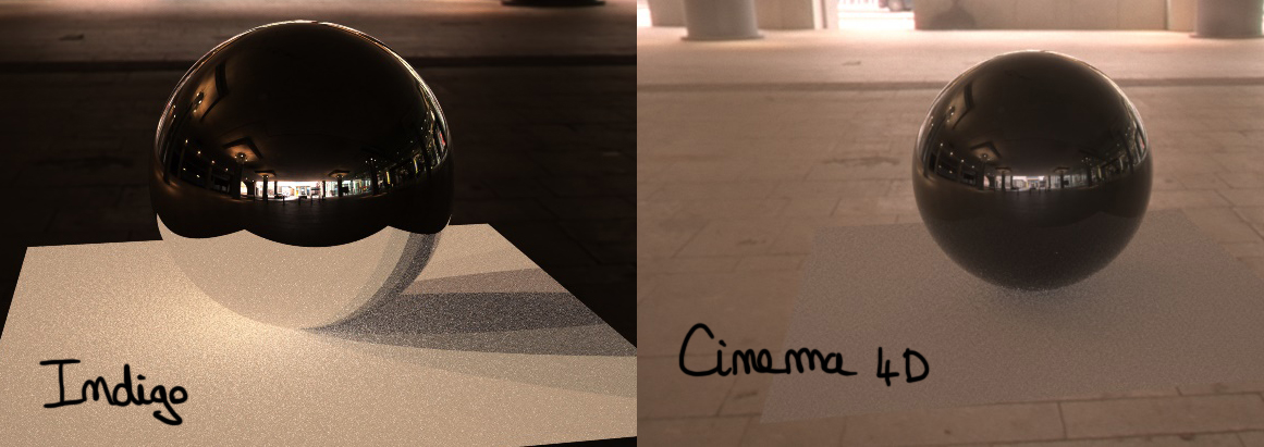

Here is what I was talking about, quite an issue for me... I would like to work seamlessly between both applications.

Hey Mroz,
this difference is way stronger then what I had found in my testing.
BUT:
You need to have same camera for comparison! If you for example use Reinhard tonemapping (default if not changed via Camera Tag!) the brightens of a scene gets changed dependent of its content of what the camera sees, just like the human eye that adapts to light!
Anyway the difference looks to strong to be only related to Reinhard tonemapping...
It would be great if you could provide this simple scene to the devs, send it to support@indigorenderer.com with a link to this thread, they will check out whats wrong here.

Thanks for your reply Zom-B,
Yes, the camera was the same in both images, I'll send a scene where it was quite obvious!

I was relating to the camera position/angle actually. Reinhard Tonemapping is adaptive to what is seen by the camera, changing the angle, also changes the content of the camera and the adaptiveness changes the whole look regarding brightness etc.MRoz wrote:Yes, the camera was the same in both images, I'll send a scene where it was quite obvious!
You could try linear or camera tonemapping, they are "static" and don't adapt to the content they see.

Oh yes, sure! Haven't moved in this example, Reinhard here, but the chocolate candy was on Camera mode and the difference was also huge.

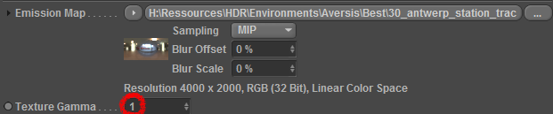

This looks like a gamma decoding issue. The EXR should be loaded with gamma=1, it looks like it is loaded with gamma=2.2 or so by Indigo

That was exactly that galinette... Thanks! I think Cinema 4D automatically concider that this is a linear profile but Indigo doesn't, so I didn't understood... So as you said you just have to change the gamma to 1.
