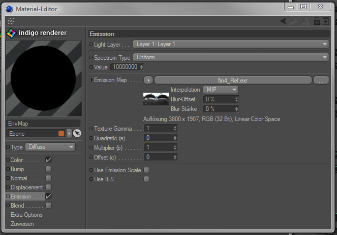

Also take care to raise your Spectrum strength to a value that is high enough to bright up your scene, see attached screen for that.

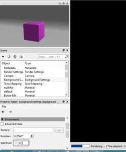

Thank you for your hint. But the problem is the Texture is not exported to indigo as you can see on the screenshot.

Zlaty Lev wrote:Thank you for your hint. But the problem is the Texture is not exported to indigo as you can see on the screenshot.
Just an idea: It could be that the emission channel is not checked.
If it still doesn't work, could you send the scene, including the texture you are trying to use?
