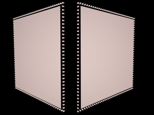

since 09.t8 I had some strange issue that (some of) my renderings become totally black after getting displayed accurate first in the indigo viewport :shock:
Can somebody confirm this?
I'll try to do a reduced scene that has this issue tonight...

This Issue seems to be light or material thing, because this scene rendered fine before I added some materials and lights...
only rgb lights are used, and 2 rgb light texture emitters.... but I got this issue with another scene that uses only BlackBody for lightning!
Here the zipped igi file (25 min rendering!).
25 min rendering linear tonemapped in VioletR12P1b3.
Post by Zom-B » Tue Oct 09, 2007 3:11 pm
Hmm... you can see it in the "rendering" above the grey plane sorounded by lot of light bulbs.
The Problem is, that both meshes got the same light settings :shock:
So why do the got different brighntness? I did some testing:
RGB Light 1 1 1 - Efficacy Scale: Power drawn 95, Overall luminous efficacy 14
No Background lightning, Reinhard 3/1/10, D65
Using no Efficacy Scale or merging all 4 meshes together causes this result
Same light settings for all 4 meshes!
light_issue.zip
The Exported igs + meshes + C4D Scene file
(1.1 MiB) Downloaded 351 times

Post by zsouthboy » Wed Oct 10, 2007 1:36 am
@ZomB:
I believe that is correct result: the larger surface area with the same light output as the smaller surface area appears darker per pixel of the output image.
Post by StompinTom » Wed Oct 10, 2007 1:36 am
your light power difference could be because the planes have a much greater surface area than the bulbs around them.
power\bigger surface area=less output per unit area. and vice versa.
Post by Kram1032 » Wed Oct 10, 2007 4:12 am
The efficacy scale doesn't give the relative energy amount / meter but the absolute one! It will get divided through the area.
To get similar results, you need to re-multiply/-divide the values with the area.
Post by Zom-B » Wed Oct 10, 2007 8:52 pm
Kram1032 wrote:The efficacy scale doesn't give the relative energy amount / meter but the absolute one! It will get divided through the area.
Thanks for pointing this out guys... learned something new today :wink:
