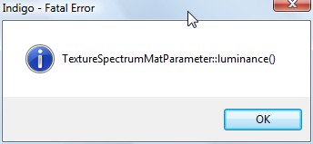

Post by Whaat » Thu Jul 24, 2008 4:33 pm
I get this error message when i try to apply a texture to <base_emission>
Non-textured emitters (constants) are working so far.

Post by Whaat » Thu Jul 24, 2008 4:53 pm
Fatal Error: IndigoDriverExcep: SceneLoaderExcep: Found unexpected element 'texture' in element 'phong'. (Around line 106, column 17)
What's the deal with the new way to specify textures? (i.e. texture indices). I got it to work with diffuse materials but I get the above error with Phong materials. Does this new format only work with diffuse materials?
EDIT: Same error message with oren-nayar materials as well.
That's a bug which I've fixed in my code now. It should work for Phong and Oren-Nayar in the same way as with diffuse.
