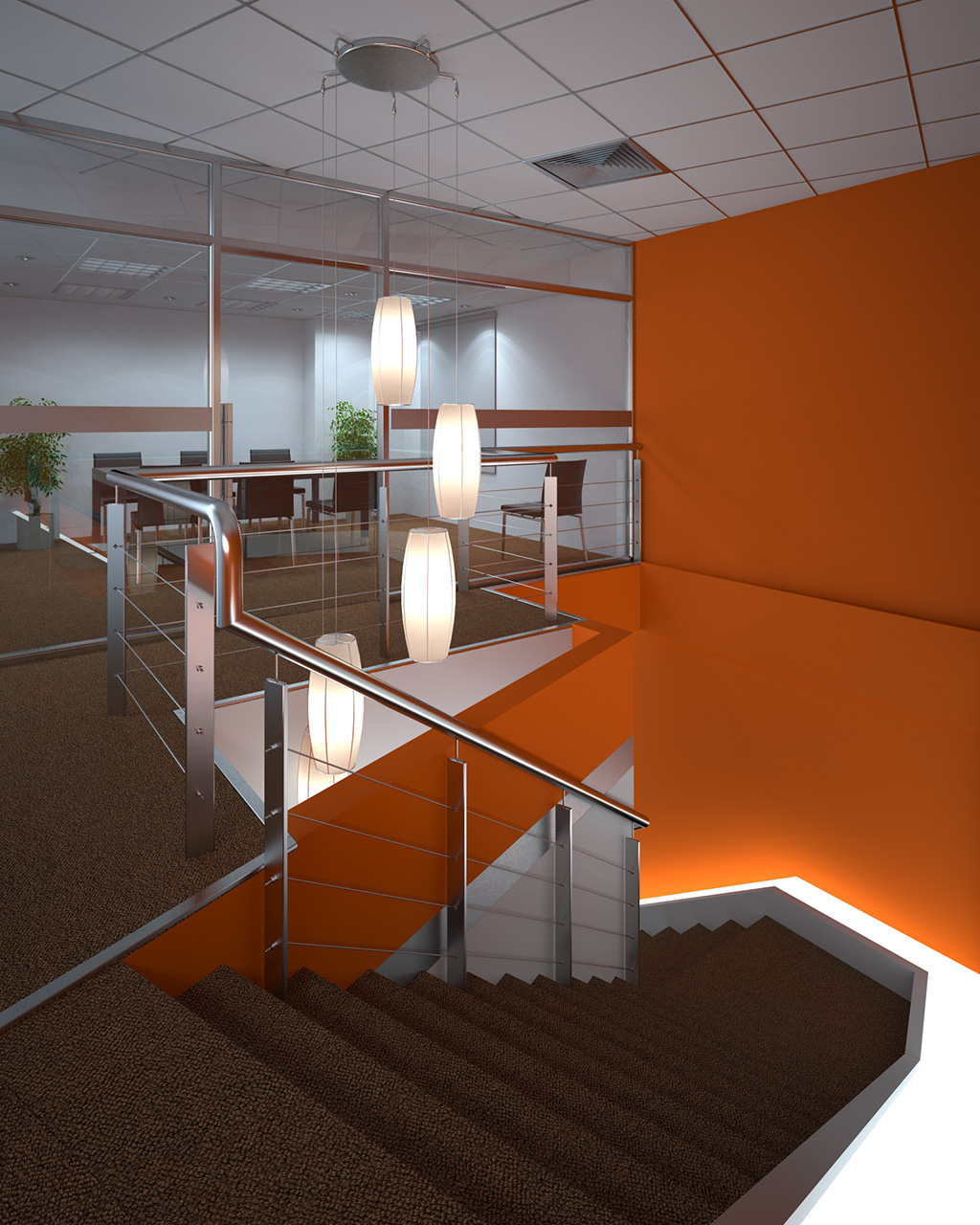

Hey Guys...
I was one of the two how offered a Scene to render, here is my "report":
I used a 8 Layer Scene file that was rendered in 1600 x 2000 for 45 minutes, getting 11152 samples per pixel with super sampling @ 2. The total time of the project was 1 h 01 minute, including warming up, rendering and the merging of 128 IGIs of 1.05 GB each (around 12 minutes for the merging alone).
Merging the igi files is here something that can cost some $ if you use a lot of layers, so you can do some math, because The IGI gathering+merging is FREE if the render time of the project is >= 60 minutes!
You also have to remember that I actually get 8 images here, and not only one! you also can simply resume your rendering at home, mix your layers as you like, and then save th output!
I attached some results and also a link to the final image @ 1600 x 2000.
In my scene I used some original glas for the window of the conference room. There is still some little noise visible behind the glass, but this simply shows that Indigo needs some work(arounds) in this area. And yes I know that this scenario is a general problem for raytracers, but I'm sure there can still be done some stuff
Also some cr.nk phong materials have still some noise left... I think this need some fix too Ono! This 45min image would render on my 2x2.8Ghz iMac for over 17 Days!!1!
HERE is the link for the original output file saved as jpg with 100% quality (1.7MB)

- The final output resized!
- final_output.jpg (393.69 KiB) Viewed 9018 times

woaaaa, really nice example of using layers !

sorry Suv, mentioned it always when posting it but forgot it heresuvakas wrote:@ZomB
Could you please refer to the origin of your scene next time?
I just saw this scene on one of the Evermotion DVD's. I really thought, that it was made by you.
At least the carpet and all the light (management) is from me...
