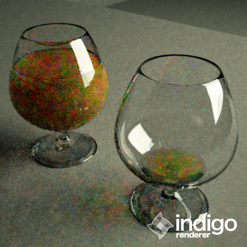

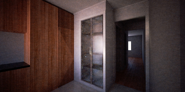

Whaat
Posts: 1827
Location: Canada
Re: Indigo 2.0.10
Post by Whaat » Thu Jul 16, 2009 2:42 am
benn wrote:The samples/sec may be slower but the SSS material should resolve faster.
Well, there are definite issues between 2.0.9 and 2.0.10. Whatever Ono changed to optimize scattering for uniform spectra also has affected non-uniform spectra. I rendered the exact same scene with 2.0.9 and 2.0.10. There is no question that the noise is far greater in 2.0.10 for the same amount of time.
Also, the 2.0.10 images looks darker even though I have the same tonemapping settings (maybe it's just darker because it's noiser...)
Indigo 2.0.10 after 20 minutes
Indigo 2.0.9 after 20 minutes
