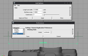

I'm definitely not an expert with Maya, but while I agree with the centimeter default unit, I don't see how you can get centimeters and meters at the same time?
Here is a screenshot of my settings, with 1 grid line = 1 unit = 1 cm (and a measured model of 14cm)
Is it okay if I choose a scale modifier of 1 then?
Of course with 0,01 the render doesn't blur "everything" as I said, but the dof is extremely short, as it would be with milimeters...

Well, the scene scale modifier is currently replacing the Maya preferences regarding linear values. It defines the length of a grid unit in meters.
I agree that's not intuitive and I always planned to change that, it's just that I gave it a low priority until now. I reckon also that, if it has to exist it would make more sense as a multiplier for the Maya linear setting.
Good points Lemo, I took notice thanks !
But for now the parameter must be left to default so 1cm in Maya = 0.01 meter in Indigo. For example someone using inches in Maya should set it to 0.0254.
OnoSendaï doesn't like this kind of parameter at all, and as a matter of fact it is reducing geometric precision (of 10e-8 though, not huge). I may simply remove it and have Indigo match Maya's scale straight away.
Would you miss such parameter if I was to remove it ?
Conversions will still have to happen within Maya though... well I'll check about that.
If you are having troubles to get the centimeter sized objects in focus you can use a camera and aim (2 nodes cam) so to visualize the focus point (with auto-focus turned off). Try a greater f-stop, it's working for me.
