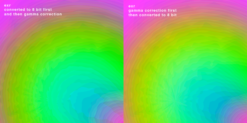

here are some tests I made to show the banding I've been dealing with. just flat sky with camera tonemapping (color is super-exaggerated, of course, to highlight the problem).
I tested converting the gamma of the tonemapped exr in photoshop both before and after downgrading the file to 8-bit rgb and you get similar banding either way. (2nd image)

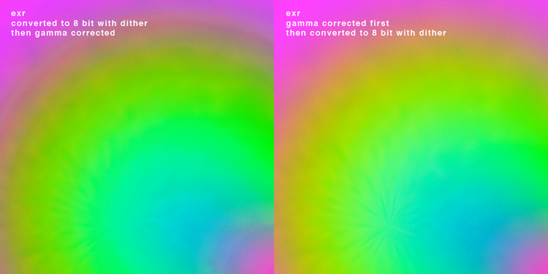

the main thing that seems to be missing in Indigo is a dithering function. If you convert to 8 bit from 32 in photoshop, using dithering, it eliminates the problem (3rd image). you get a slightly rougher grain structure if you convert to 8bit first and then do the gamma correction, but still, no banding.
8 bit png output from Indigo
exr conversion without dither
exr conversion using dither
