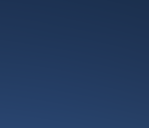

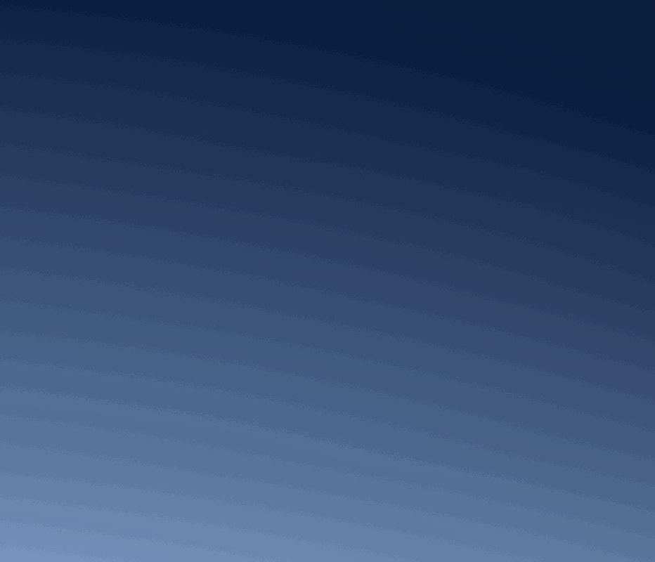

most of the time 8 bit is fine for my purposes, but I've had to deal with color break-up and banding on occasion (see attached image) and in 16 bit you have a lot more control over those kinds of issues. the sample images here were made with the new sky model, by the way (awesome).

banding in the sky
exaggerated with a pshop curve

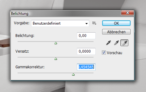

setting The Gamma is done in the "Exposure" setting In PS for example, see image:

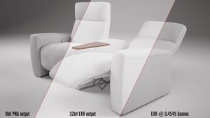

Here a example of the output:
Doing this comparison I just stumbled upon some small but visible differance in displaying the dark areas of the image, see here for the Bugreport.

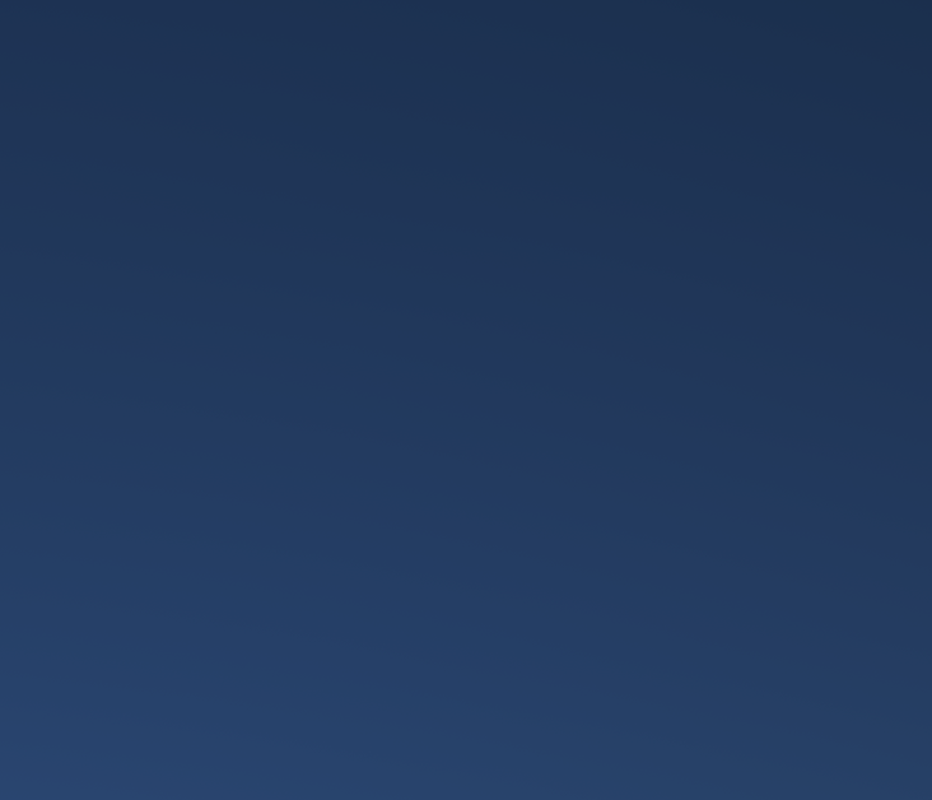

still, I get a slight but noticeable color shift when I do that conversion. it is much better than I was experiencing before, but still not quite right, (see attached). I think your bug report is correct...
tonemapped exr with gamma correction
8-bit png output
