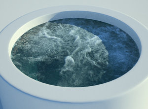

here, I thought I'd take a shot at this. it's basically Ono's suggested approach with blend of specular and diffuse.
the scale of displacement needs tweaking depending on your scene scale. plus the texture values for blend and displacement will depend a lot on the images you are going to use.
I also used one material for the top of the water cylinder (bubbly blend) and for the sides and bottom (plain water with blue-green color), those both have to share the same medium.
this would probably benefit a lot with the photon-mapping methods that are in the works too, cause the water parts take a while to clear up and are pretty dark.
anyway, something to play around with and get you started. it's a pretty cool challenge.

Looking good FakeShamus!

awesome, up to the MatDB!

here, it works much better with simple color absorption in the medium instead of absorption layer with an image texture. also made the bubbles a uniform color phong instead of image color.

Wow, awesome material! :shock:

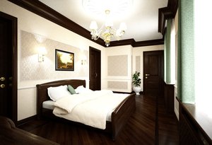

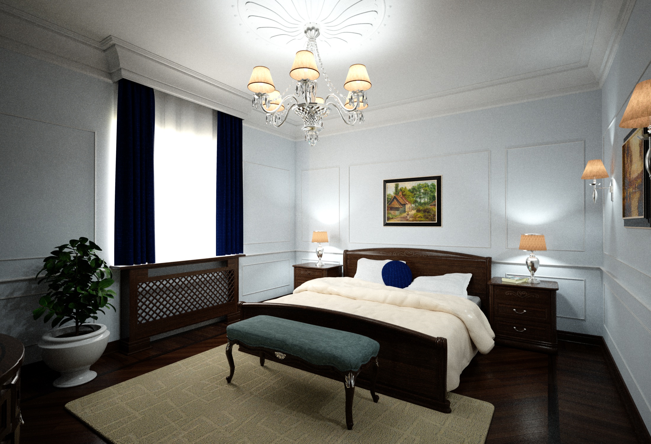

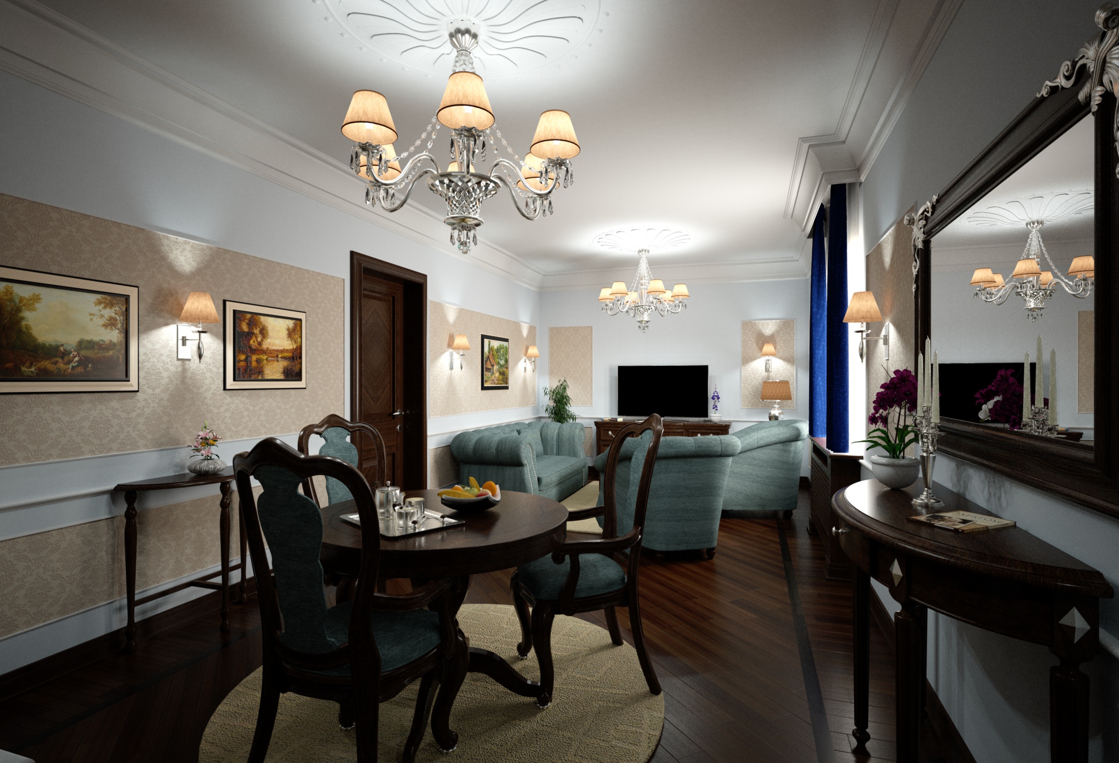

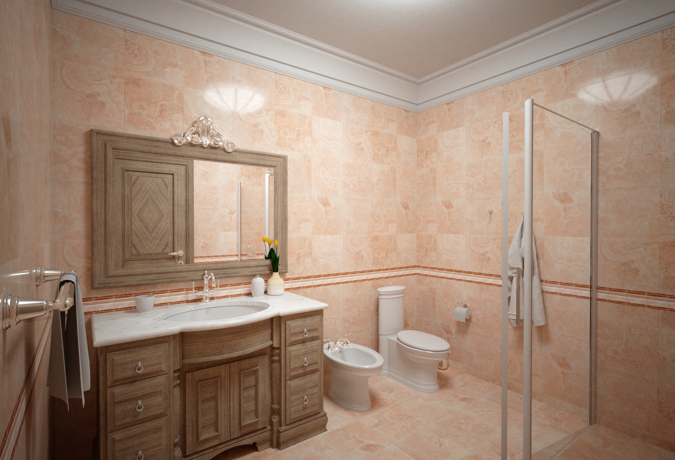

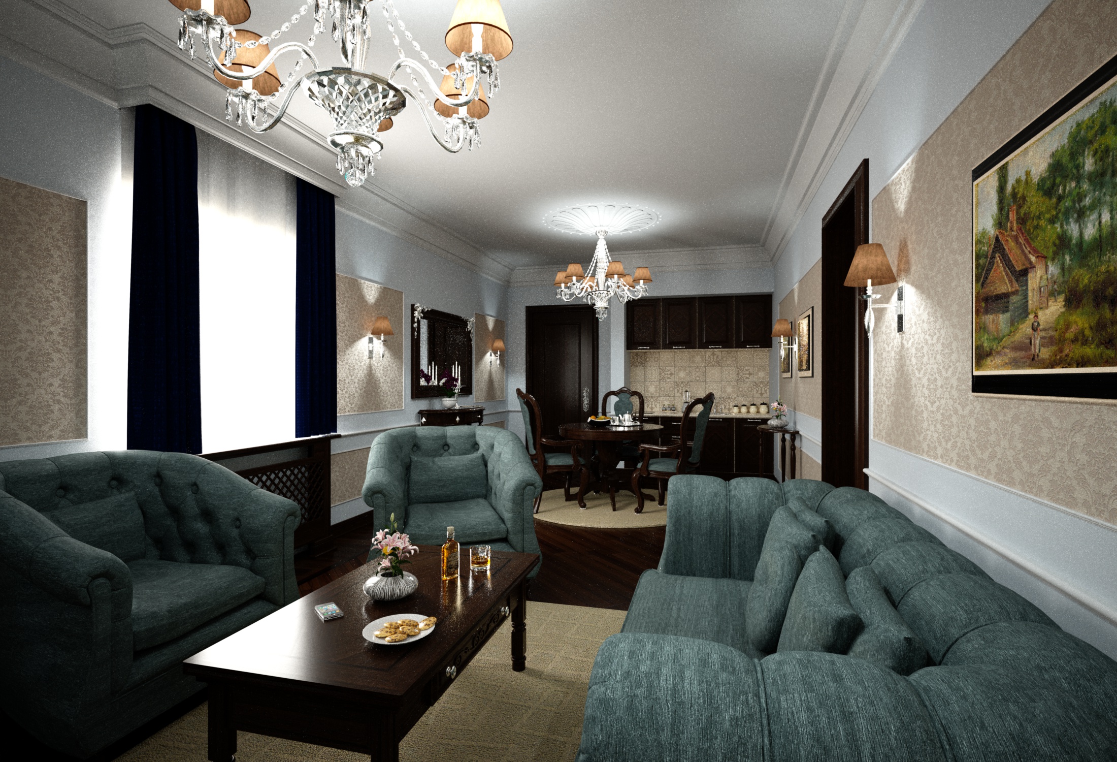

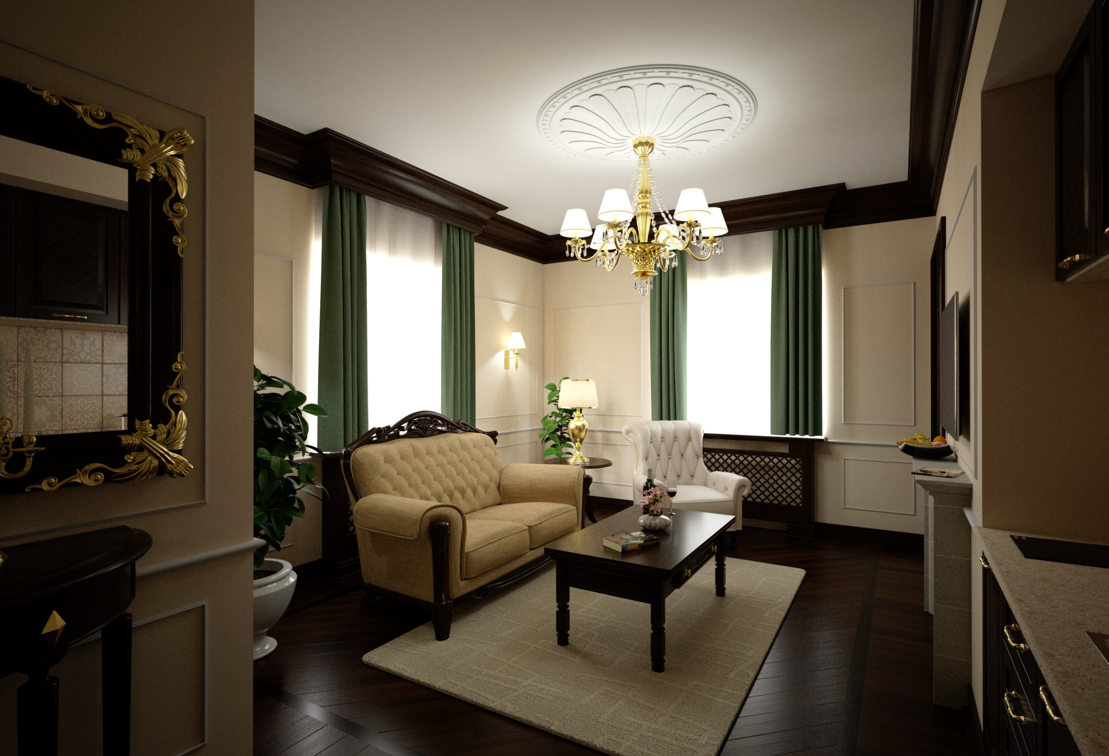

Hello guys, first of all I want to apologise for my so late respond. During my strugle with jacuzzi effect I sudenly got a new task from my boss and I needed to pause the spa interior project. Today I finish spa interior and I decided to share with you both of my works. That suden task was interior design of catering apartment in vila, the interior was desired as light classic. And I am happy to tell you that it is accepted by investor. As for spa center, it is existing building which demands heavy reconstruction. Interior was desired to be luxorius and modern.
In this comment I am uploading catering aparment in vila, in second, I will upload spa center.
And ofcourse, I owe a big THANKS to FakeShamus for sharing this awsome material! Thank you mate! :)
c&c are welcome as always! Hope you'll enjoy! :D
bubs
Posts: 620
Location: UK
Re: Jacuzzi effect?
Post by bubs » Sat Feb 28, 2015 12:25 am
Very impressive modelling and scenes! 8) Excellent work, my only comments are, the mapping for the brick on the back of the fireplace is a little off IMO (but I'm being really picky here!! :lol:) and that there is some noise, a bit longer rendering and these would be spot on! Well done! :D

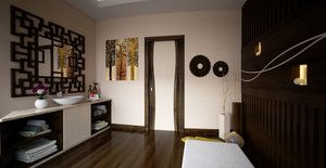

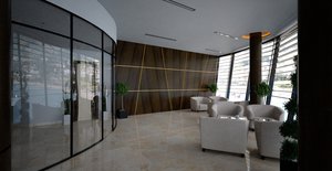

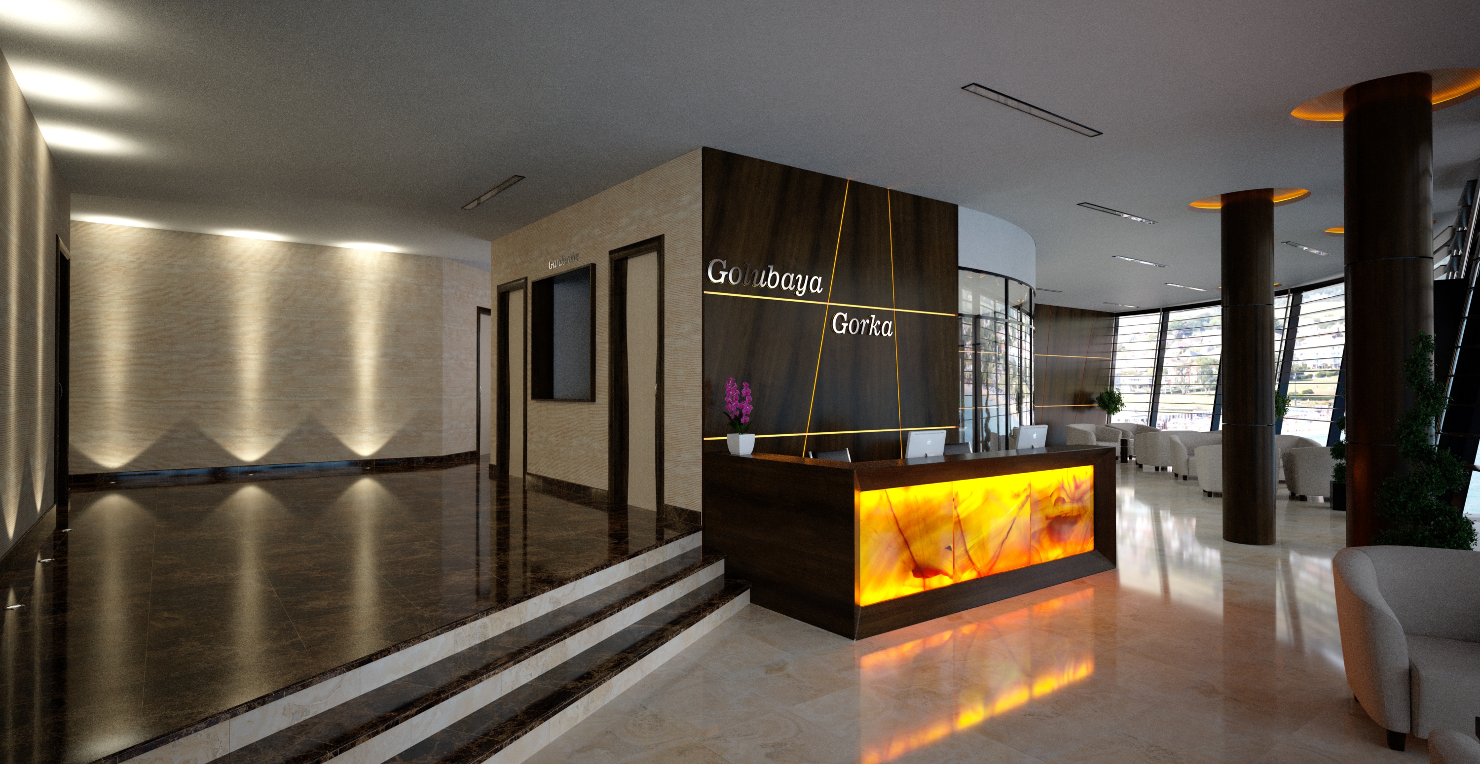

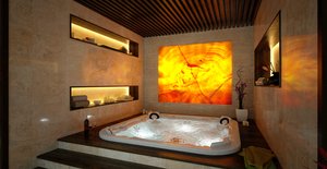

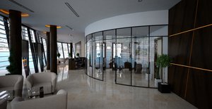

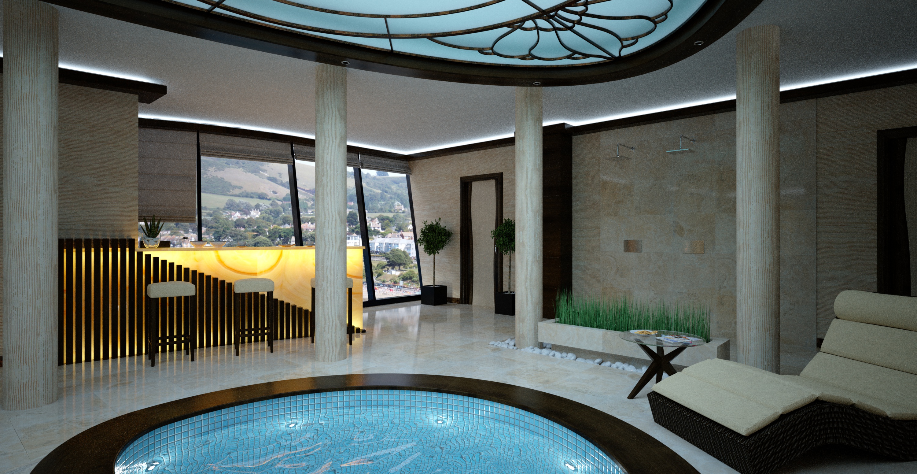

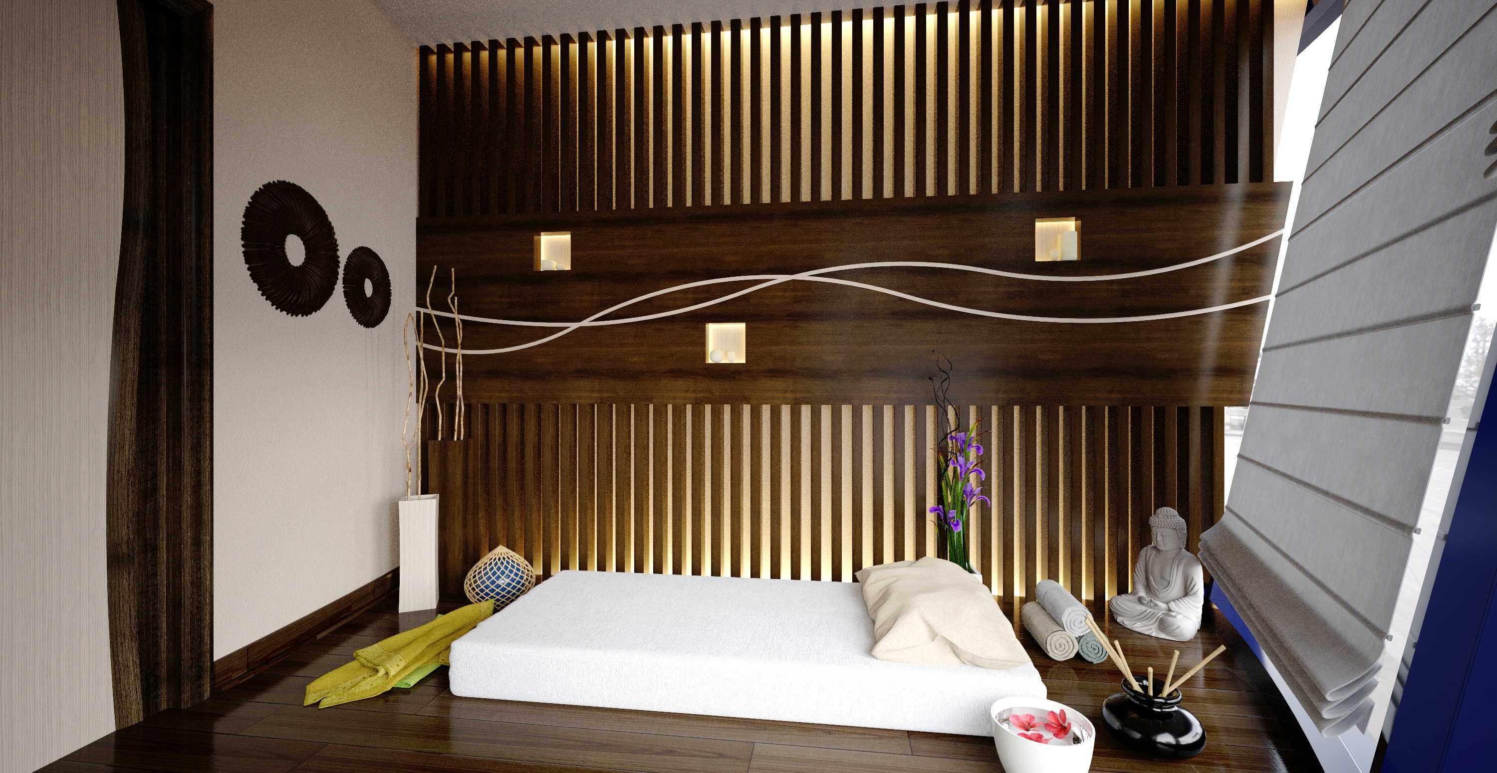

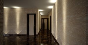

Post by Pikadili89 » Sat Feb 28, 2015 12:31 am

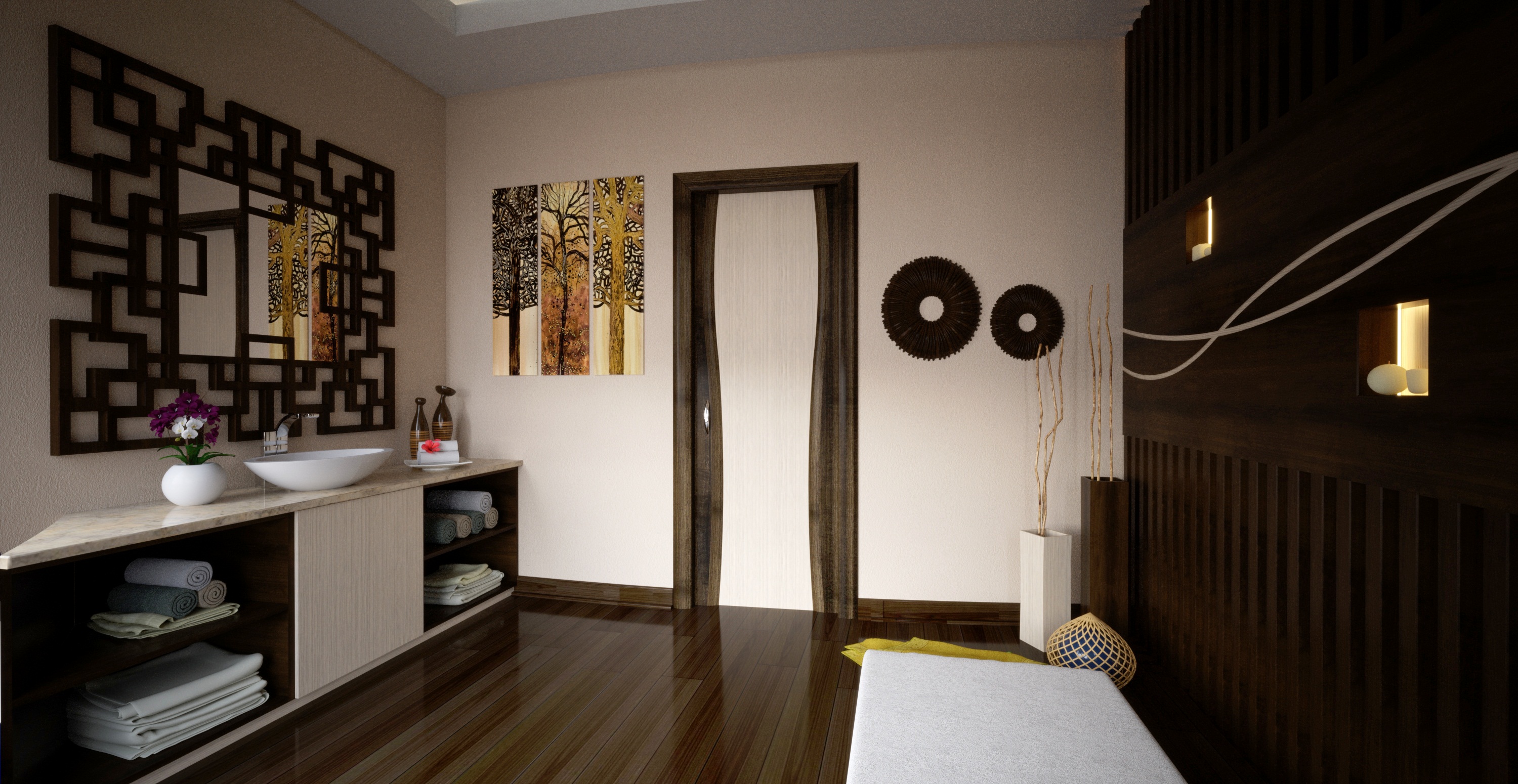

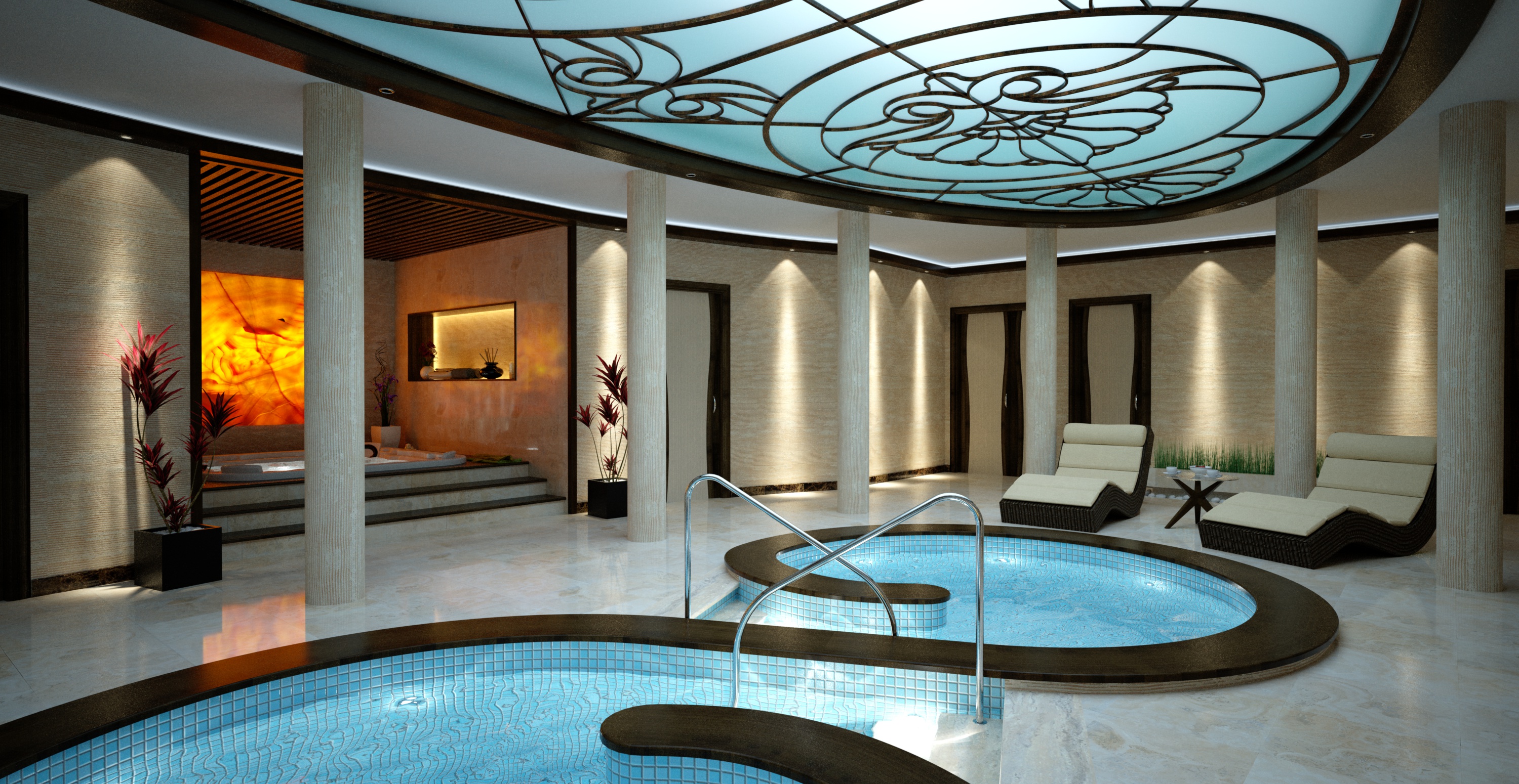

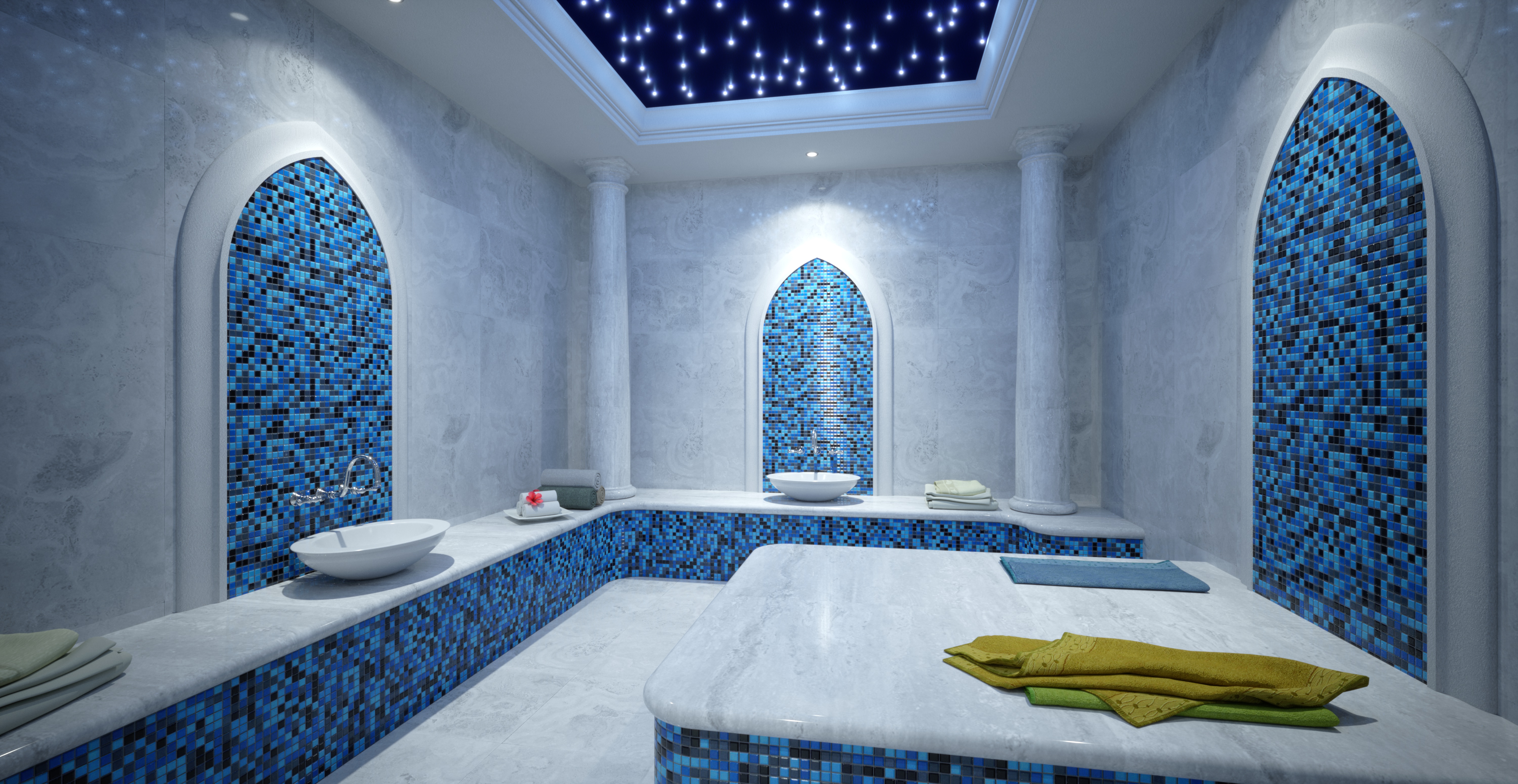

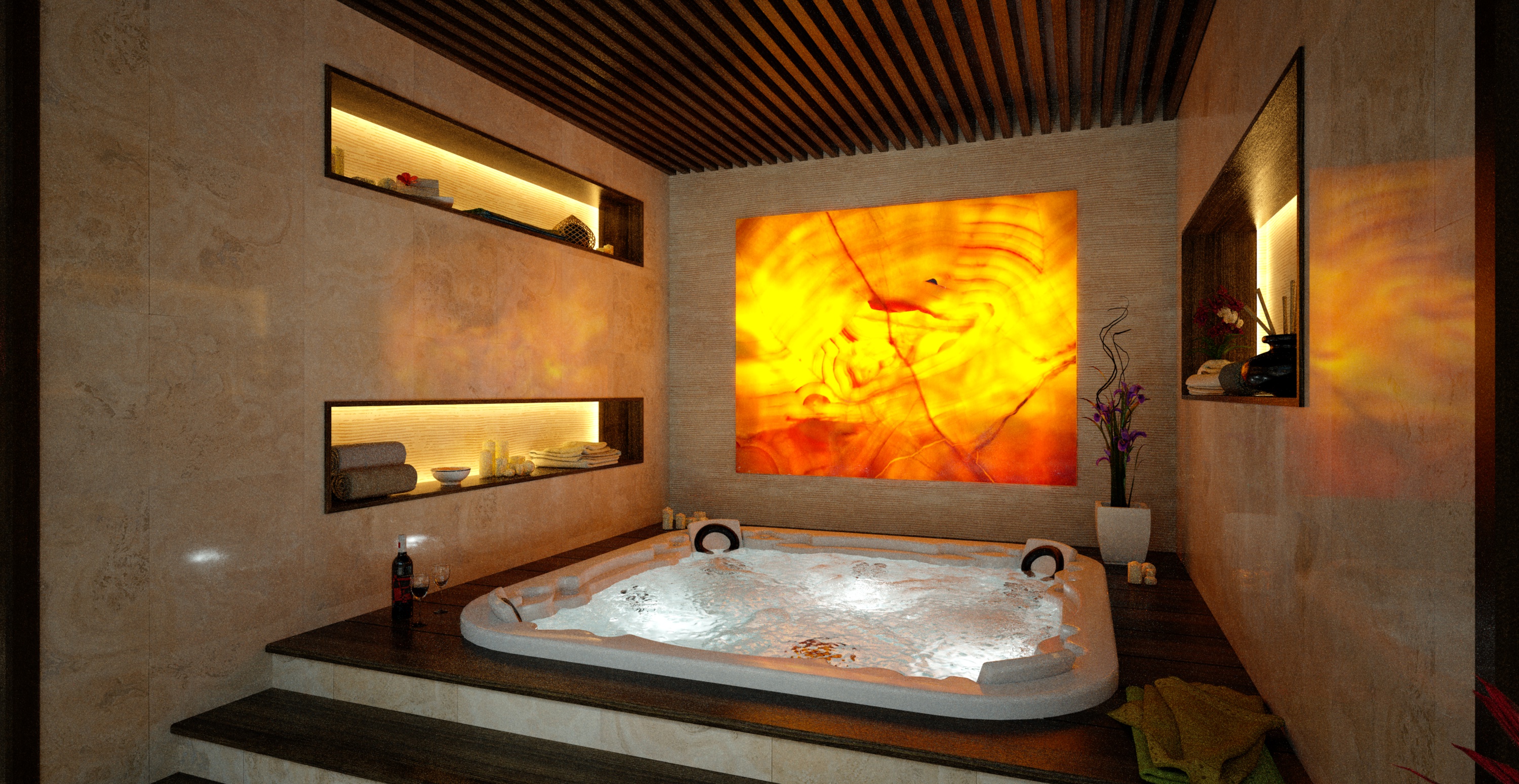

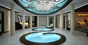

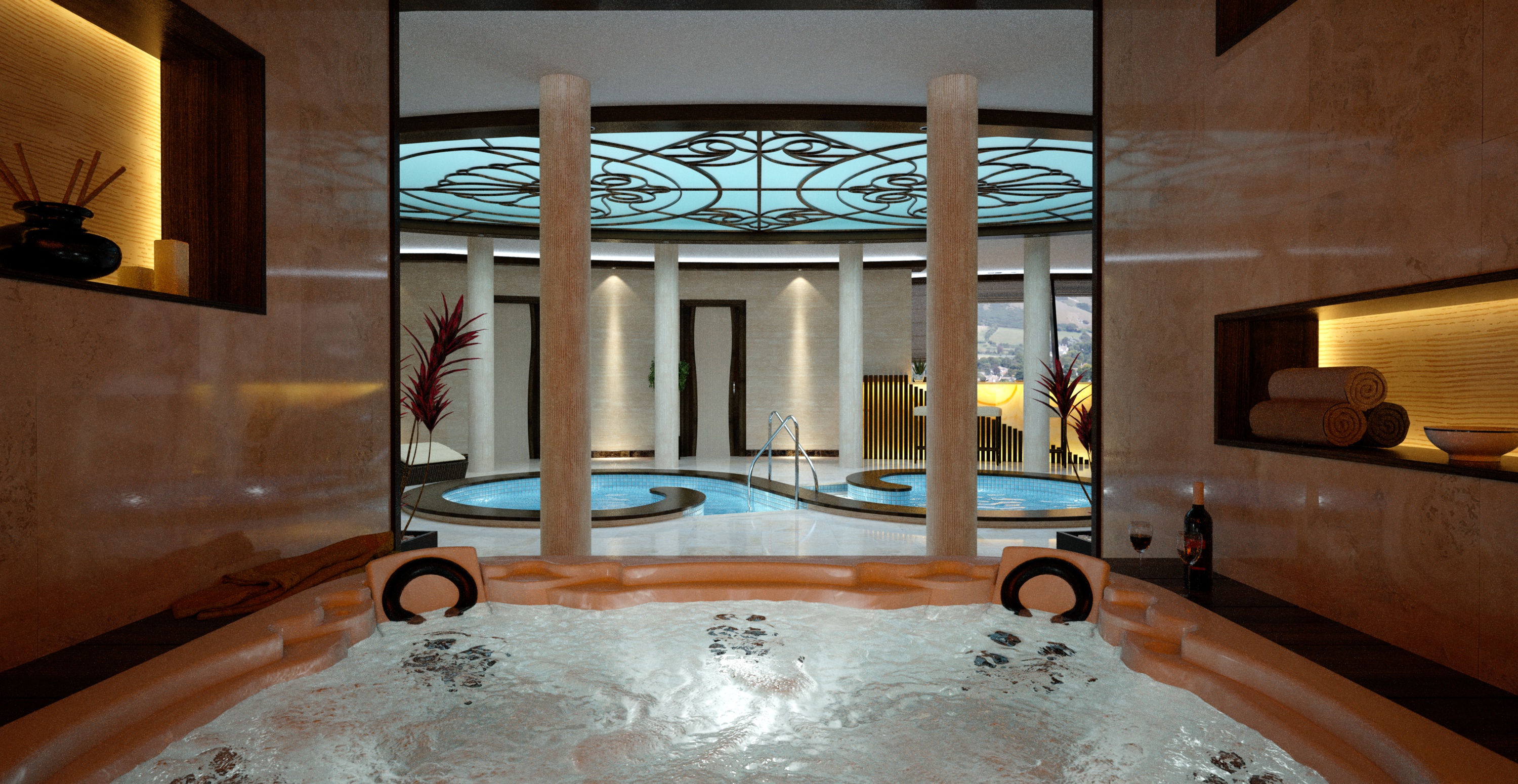

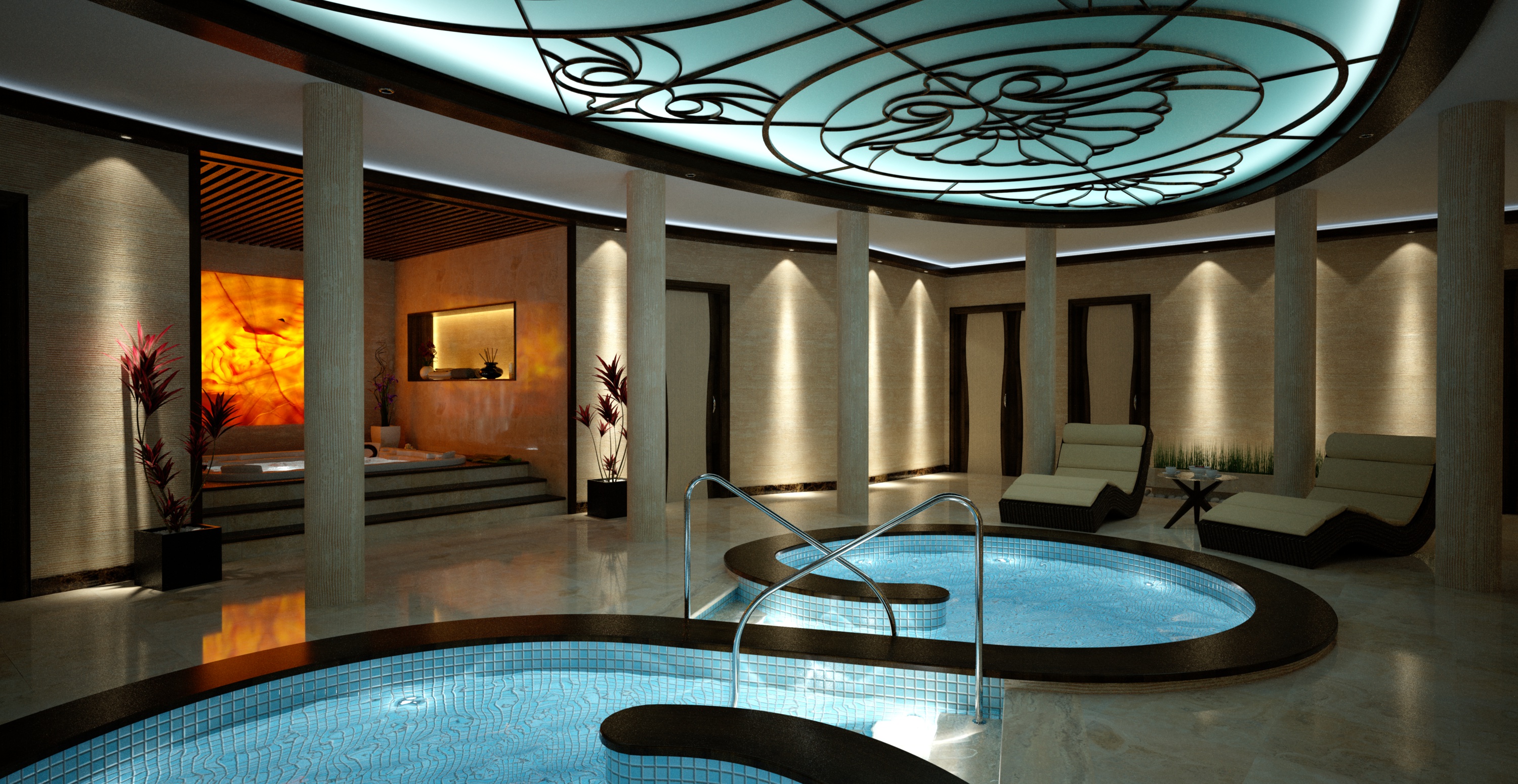

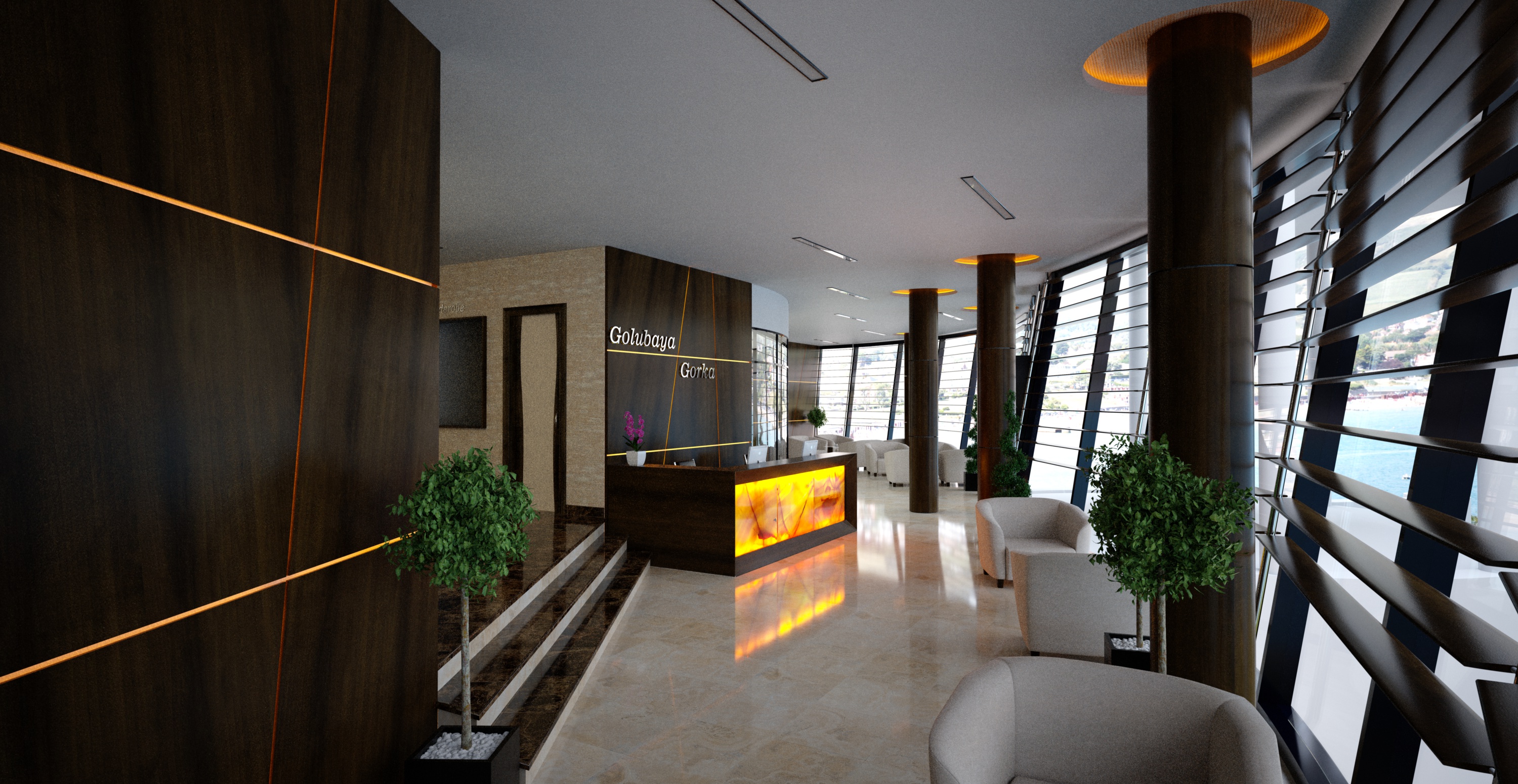

Spa! :D
