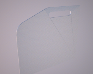

I am trying to render a metal panel (among lots of other things) made from brushed aluminum. When I run the render, I get some weird lines showing in the plane of the panel. They seem to be part of the wire frame though there are no lines at those locations. I think they are some part of the geometry as an export to Kerkythea uses the same lines to define the object. The artifacts at the bottom aren't an issue at the moment.
How do I keep those from rendering?

- Re: Lines from bottom left to curved corners. In some renders, they are extremely prominent and the area between the lines is darker.
- Panel.png (95.65 KiB) Viewed 7781 times

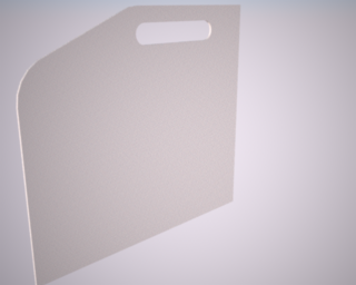

Re: Wireframe Lines Coming Through
Ok, that's what I've done:
- I select one single face (triple click on it).
- right clic on it, select soften smooth edges.
- Angle between normal: 20 degrees and select both:smooth normal and soften coplanar.
The Fredo6 plugin allaws you to round corners: Notice in real life obj theres is never 90º sharpened edges. You have to round them even if it's very subtil. So your renders will look better..
That seems to resolve the problem. Thanks!!! Does that slow down render times as there are more faces? I guess I don't quite understand what Smooth/Soften does.
edit: Nevermind, that didn't do it. I even opened a brand new sketchup drawing and made a similar sheet with similar results. I am thinking it has to do with the material. When I leave the material as a default Sketchup material, it is fine. It also works fine with the presets. But when I use the Brushed Aluminum, it causes that. I'll redownload it and see if that fixes it.
edit2: Definitely the material. I downloaded it again, imported it straight into the model, and rendered and the lines are there extremely bad.
I REALLY like that brushed aluminum texture as it looks on the Indigo model but I could never get it to look that good in mine and this problem kinda kills it for me. I'll try other metals to see if it is a metals problem.

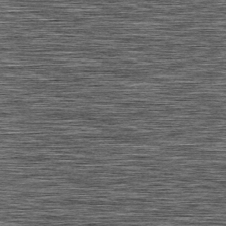

I know but I'm not skilled in indigo shader language. I know you wont get the same but try to use this texture as a bump map,(isntead of shader choose external) /position map in the model/ accept / set it to 0.0004 and reduce exponent number until you get it. Try searching in the net other brushed metal bump maps as well and do a lot of experiments.ieatfish wrote:turning it off is the right thing to do...
