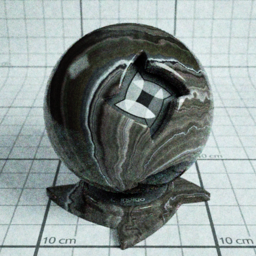

Post by OnoSendai » Thu Sep 25, 2008 2:19 pm
Ok, now we're talking:
This is a similar technique to the last shader, but pulls the colours from a 1-D slice of the source texture I've attached.
Also I'm moving the sampling coords with world space position properly now, as opposed to the last shader.

Post by CTZn » Thu Sep 25, 2008 3:13 pm
OnoSendai wrote:Erm, I am already using the FBM to perturb the position that is sampled from the 1-D 'colour function'
Ah well yes you "remapped" the fbm with col, now I understand that. That's not the same than remapping col placement with fbm. The effect is different, but the technique could be the same, using getTexCoords ? I have hard time grabbing ISL flow... will try harder.
Ahw beaten bad, now that's yesss !
Hey that's like a grain sampler !!! Thanks for commenting it, too !

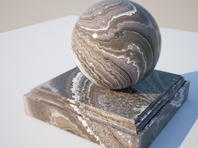

Post by cpfresh » Thu Sep 25, 2008 8:20 pm
heres my go at a marble shader.
Post by CTZn » Thu Sep 25, 2008 9:15 pm
It's very good cpfresh, code would be apreciated :) you are using a bitmap too !

Post by cpfresh » Fri Sep 26, 2008 7:22 am
hiya CTZn! i can post you the code later on. all i did was use Ono's code from above and then added a little noise -- kinda combining one of his very first shader tests (which was posted to his DA page) and this latest one. because like i said before i liked how your marble image had kind of a arced pattern as opposed to a straight line pattern in it. so it turned into another function call before (or after) the color call (i dont recall which.) also i used a different marble image (which i found on the inet) for the coloring. anyways, stay tuned.

Post by cpfresh » Fri Sep 26, 2008 1:22 pm
oh man that grid code is so much nicer than mine :O Ono, is fract() going to be a permanent addition to the ISL? also, i see you used min in the grid shader, how are min and max defined?
below find my code for the last bit of marble i put up, im sure there is a better way to do the little distort function i made, suggestions? the base portion of that was taken from one of Ono's very early tests.
in general i just tweaked Ono's code.

i'll also attached the reference image i used for the color sampling.
the marble
another sample
