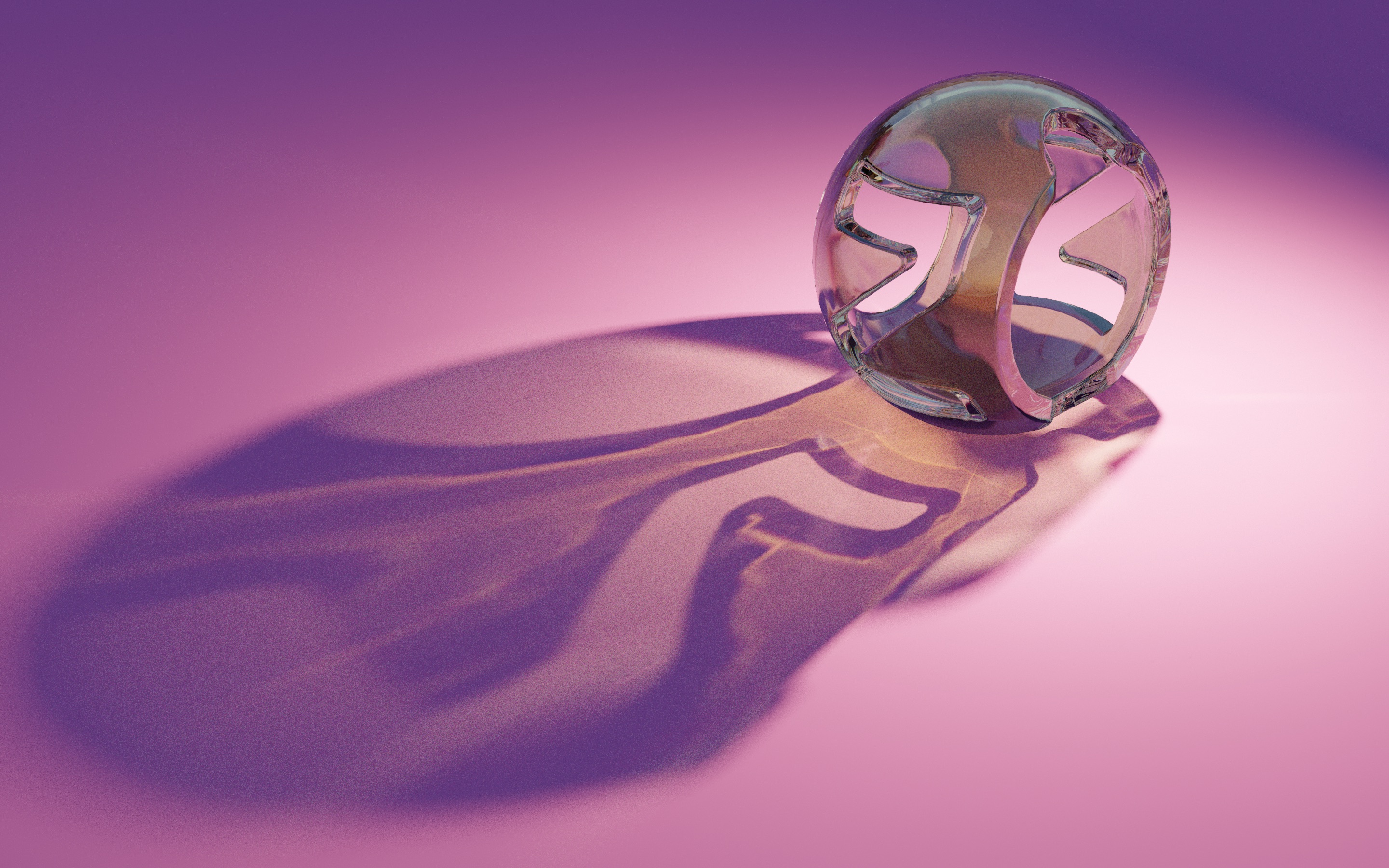

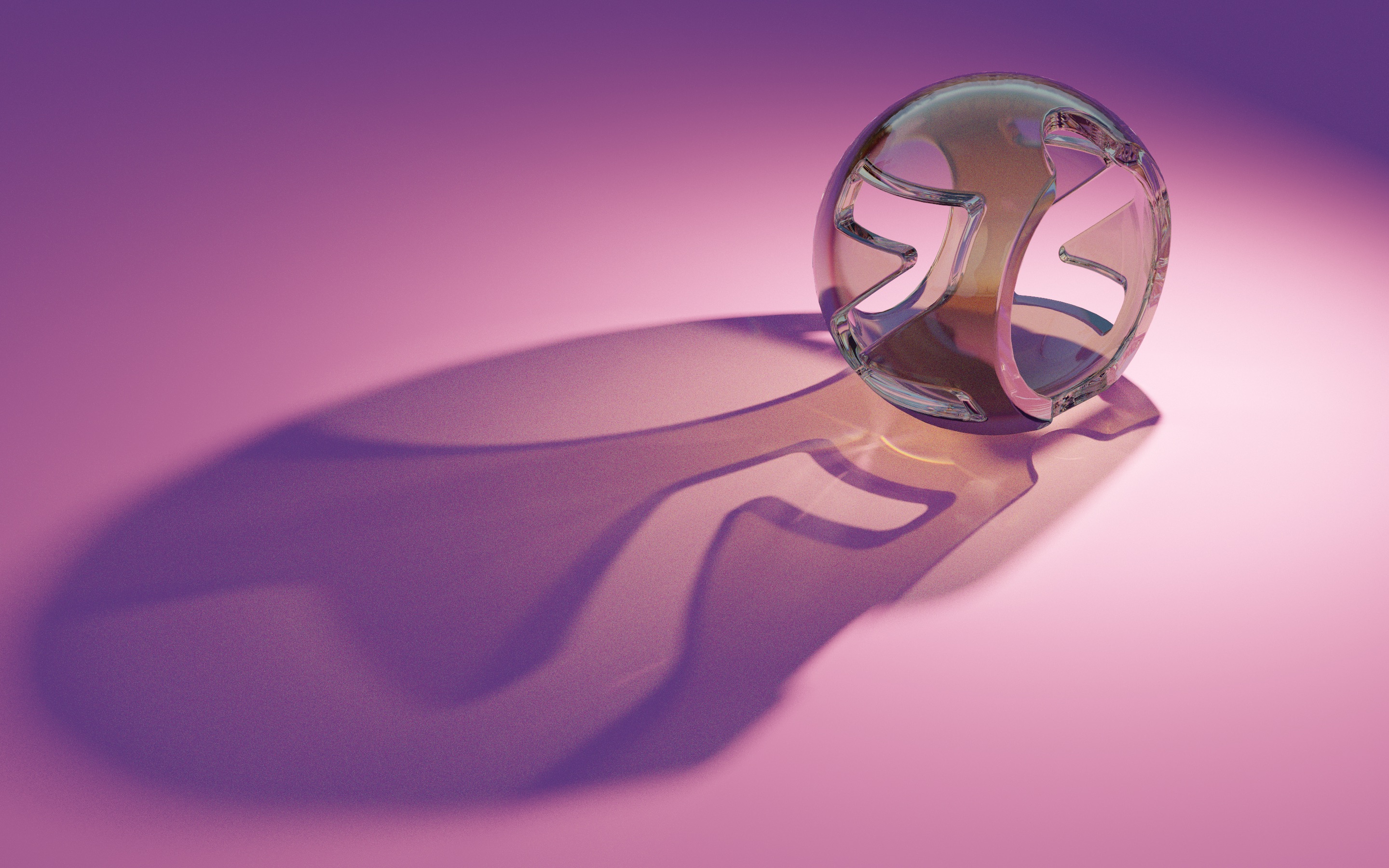

I am not sure whether or not this needs to be supported in Blendigo and Indigo.
CAD models, when exported as .obj contain custom vertex normals (custom split vertex normals in Blender).
This helps reducing render artifacts and can only be worked around to a degree by exporting models with very high polygon counts.
The model in the images below has 21k faces/triangles. The images were created in LuxCore, which only started supporting custom split vertex normals with the latest 2.4 release.
The 1st image is based on a .obj, which includes custom split vertex normals, the second image is based on a .stl without custom vertex normals. The differnce is pretty clear.
When exported from Blender with Blendigo and then rendered in Indigo the result is the same as the second image, regardless whether I render the .obj or .stl.

When imported geometry has custom vertex normals, the Object Data Panel in Blender will allow you to clear the Custom Split Normals Data. Otherwise you can add that data. The imported .obj does have custom (split) vertex normals, as expected. The .stl does not, also as expected.
In LuxCore render the results of the .obj and the .stl are what you see in the images. LuxCore render only supports custom vertex normals since the latest release. With Blendigo/Indigo the results for both, .stl. and .obj look the same and look like the 2nd image.
That indicates to me that there is no support for Custom Vertex Normals in Blendigo/Indigo abd unfortunately it "renders" Blendigo/Indigo" as somewhat useless for rendering geometry created originally in CAD software.

1. Standard Resolution .obj this includes custom split vertex normals, and should provide better render results in Indigo, but does not
2. Standard resolution .stl. This doe not include custom vertex normals and looks exatly like the result rendered in LusxCore
3. High res .stl. This has its own problems and it looks like there is nor normal smoothing.

With the latest release of Blendigo 4.5.0 this issue has been fixed and Blendigo does support Custom Split Vertex Normals!

@pixie the issue is resolved as Blendigo now supports custom vertex normals. Do you still want the files ?
Re: Do Indigo/Blendigo support custom vertex normals ?
Attached is a zip file containing the Blender file. The main object was exported from a CAD software as a triangulated mesh in two different resolutions as a .obj. The .obj data contains custom vertex normals.
The .stl object has a similar resolution as the lower resolution .obj.
