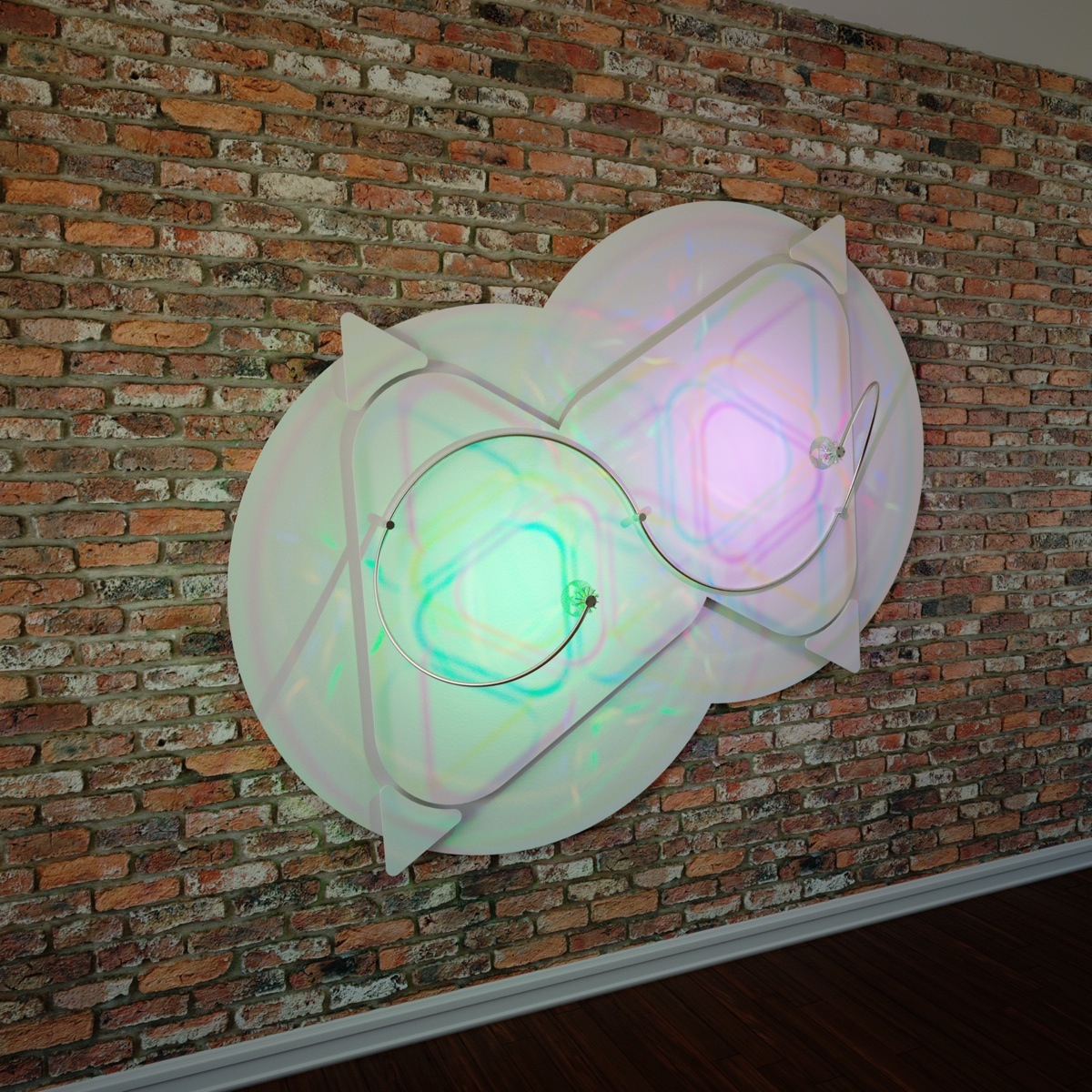

I am in process of upgrading/redesigning a halogen lighting system I built 18 years ago.
Instead of the halogen light bulbs I am going to use RGB LEDs and microprocessor (Arduino) controlled LED drivers to give the whole thing a more dynamic effect.
This is a concept rendering.
The file has 6 light layers. 1 default and 5 for each LED. I have made some feeble attempts to do a light layer animation in the Blender video sequence editor. Works surprisingly well. However as 5 LED x 3 for each color channel plus a default layer account for 16 channels to simultaneously juggle I may abandon that idea and focus getting the thing built ;-)

This is some very cool lamp, Headroom!. Congratz if you do this for a living, (and also if this is just a fun project). I'd love to see an animation if you have the time...
Microprocessor-controlled RGB LEDs are soo cool, some months ago we put almost 15 meters of RGB LED strips along the edges of the ceiling of my brother-in-laws living room, and it RULEZ :twisted:

Thanks! No I don't do that for a living, even though that would be neat. I hope to make a few more if people are interested and it would be nice if it turns into somewhat of a self sustaining hobby so it can pay for a SolidWorks license. I am currently doing the mechanical design in Alibre Design and while it is certainly capable of doing it, I have more than 10 years of experience with SolidWorks and it feels so much more fluid and quick in SW.
However, right now it is just project for fun and I am interested to see how the physical example will compare to the Indigo rendering and perhaps an animation. A general question that has always interested me aside from being able to generate nice images, how does it compare to physical reality.

Great lamp detected. :)

..the brick texture is good too, maybe a littel repetitive though...
Wonderful lamp btw: great modeling and light-mat setting!

Thanks for the positive comments!
First electronic components have already arrived and I think I'll be ready to play next week.
I am still redesigning the mechanical side of the project in order to keep cost at bay. Only the electronics (Arduino Uno, LED driver shields, LEDs and power supplies) cost about $350!
I've looked for quite a while until I found an affordable brick texture that included a displacement map.. Cost $5 on TurboSquid. I am sure there are more "out there" but often these are bundled into bigger libraries and aimed at pros (or perhaps affluent hobbyists). This one is obviously not particularly big, thus it repeats itself.
For this project where you have a light source sitting directly against the wall displacement was needed though.
