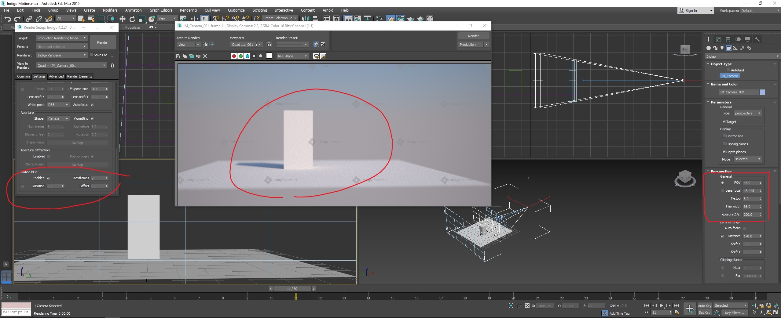

hi everyone.
It does not work.
how motion blur works ?

Motion blur works in conjunction with lots of parameters, mainly related to the camera. What I can tell you with that scene you posted is that you have to watch out for the scene size, it seems like your camera is not focusing very well. Besides that, I can't tell you that much, since I use Cinema 4D for the main platform. If it's plugin related, maybe you could mess around with your scene file, and edit it in notepad, to check if there's is a boolean somewhere, that states Motion blur=true, just to be sure.

I meant the .3ds file, from your 3ds Max. Opening your Indigo scene file, I can see that you only exported one frame of your animation, which is fine, bit it kinda gives this feeling that you forgot to animate your camera/object, perhaps? Since I can see only two keyframes for camera, which are default ones, and none for the object...better just send me the scene file for 3ds.
Add: Upon closer inspection of the Indigo scene files that were exported with my own scene, the object that was animated was exported in as many new copies as there are frames, creating in the scene files only the keyframe for the camera, not connecting that animated object across different frames. That means that Indigo sees this object as stationary, but on different coordinates on different frames.
