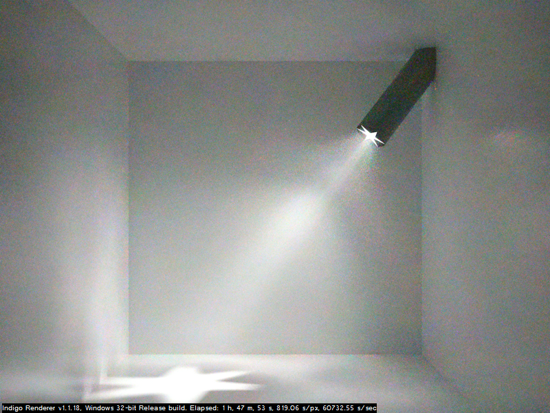

Re: Spotlights
This is not to be considered a serious render, just an illustration of what i meant in my previous post.
The star is pretty ugly, and the spotlight is just a cylinder with an emitter inside (the emitter is about halfway down the cylinder. that's why the light is not equally distributed, it gets reflected by the inner walls of the cylinder, so they act like a additionall light source).
For your purposes you should model the spotlight much more real-life-like...
The light is visible cause I used an sss medium (a cube around the scene) with an sss-value of 0.03.
Your picture is really nice, it's good to see something else than glassware or rooms with some furniture...
I think sss would suit your scene quite good, but on the other hand it is gonna take reeeeaaaalll long to get as clean as your actual image. And it's gonna loose its nice tron-like touch as well...
