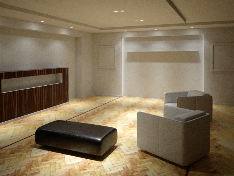

IES21 vs. NO IES
why with IES walls have a yellowish tint?
IES21
NO IES
Re: Null Black Light source with IES (C4D R14)
Post by Zom-B » Sun Jan 10, 2016 10:46 pm
Zalevskiy wrote:why with IES walls have a yellowish tint?
I suggest because the IES version has a spotlight that hits the yellow floor, from that yellow tinted light is reflected into the room.

Post by CTZn » Thu Jan 14, 2016 6:41 pm
I think you are spot on Zom-B, well spotted ! By the way, the IES version looks much better.
