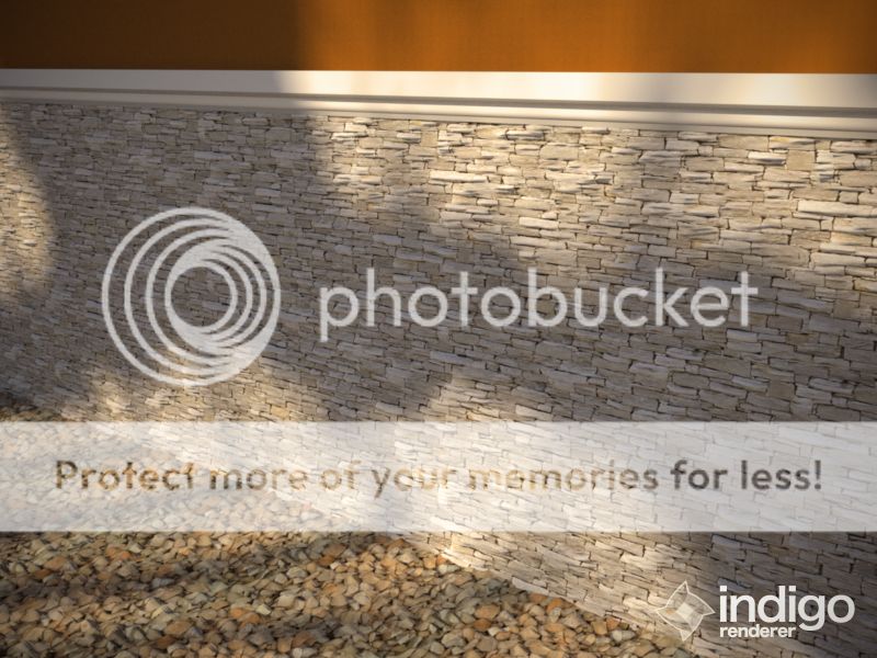

Post by Maya26 » Sat Nov 17, 2012 1:25 am
First post here..
tips & comments are welcome

Post by Zom-B » Sat Nov 17, 2012 8:22 pm
Maya26 wrote:tips & comments are welcome
Looks like a nice displacement test scene :)
But I would suggest to raise Indigos Subdivision even further!
Set Subdiv parameters to "view dependent", by that you only subdiv areas of the mesh that are in camera view and save a lot of RAM, also use the Pixel threshold, that takes care that no polygone gets subdived that is smaller then the size of Pixel you set here. But beware that this Pixel value is aiming at the internal resolution you work in, so before super sampling is applied. A Supersampling of 3 tells you that the image is renderd internally 300% of your output size, so a Pixel threshold of 3 would be only 1 pixel for your output image. I usually set it to 1,5*Supersampling value :)
If you wanna double-check how much your scene is subdived go in your material during rendering in the Indigo GUI, set it to Diffuse, and in the bottom of the material settings you got a checkbox "colored triangles" or so, hit that for some visual feedback on Subdiv!
Also beware that if your Displacement map is grey (RGB 128) centered, so that area stay "not moved", then you need to tweak your A, B and C setting like that:
C= (B/2)*-1
So lets say if B is 0.004 then C needs to be -0.002.
Otherwise you displacements moves the mesh only in normal direction for each pixel that is brighter then pure black...
Last but not least is the quite important information about how to set gamma for the texture:
If you have a Black and white map that is in saved as RGB your gamma needs to be @ 1.
If you have a grayscale image that is saved as one, the gamma needs to be 0.656565
to have the center zero point of displacement at 128.
Using grayscale images for displacement (also Exponent, bump & Blend etc.) is to prefer, it saves you a lot of RAM since Indigo loads the textures as RAW pixeldata into the system memory.

Post by Maya26 » Sun Nov 18, 2012 12:44 am
C= (B/2)*-1
Thanks a LOT Zom B!
all your comments will be noted.. :)
