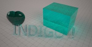

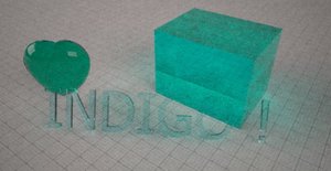

Hi, there, I've just working on some test today after I saw the Material Test done long time ago by Filippo Scarso , First I'd like to test what he has achieved before---by easily changing the Opacity directly in SketchUp to manipulate the rendering result, but I failed so bad....everything is not what I expected. I found out that the result might looks different based on the shape of the object as well as the render methods.
Bidirectional Path Tracing
and this Dark one
Bidirectional with MLT
Better this way
Path Tracing
and this
Path Tracing with MLT

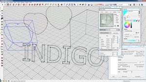

Then I made a test between different Opacity, but....it appears not that Ok to me.
First this
Opacity 13 for all objs
and it turns out like

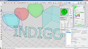

then I tried to push it to test limit
opacity 1 for all
and it look like
Big Black Hearts.....
Help me with this?
