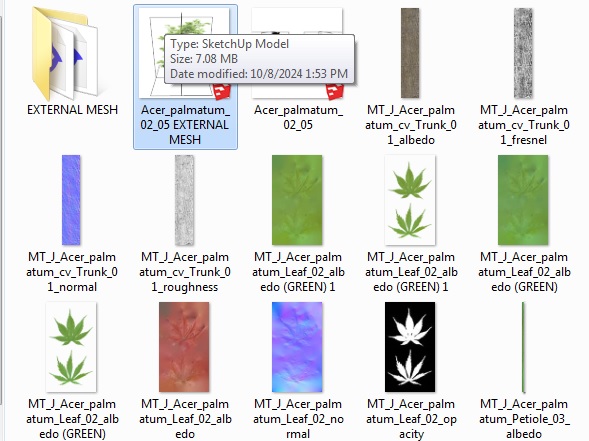

Yeah I got it, but I did a test and to be fair, using external mesh helps a lot in reducing memory usage. I don't know how it works but external mesh have multiple times less MB in files. So attached are files, images 1 and 2 show .skp file of external mesh component and folder of actual .igs meshes.
Image 3 show how heavy is actual .skp model of the tree and corresponding dummy which is ofc almost nothing, maybe dozen KBs.
So external meshes folder and .skp of external mesh component are combined about 15MB while .skp file of a tree is 63MB. When tested, indigo also starts fairly faster with external meshes than with original model and dummy.
Hope other SketchUp users find this useful
Cheers!
Cheers!

Sorry I am not checking Indigo forum so often. Actually it uses much less system RAM and GPU Vram when rendering external mesh than when using original model file/dummy.
So before I was also using transmutr to lower the file sizes of plants but in order to be remotely usable I had to lower geometry by 75% or even 95%, this of course decimated the model. Than I created dummy for so much simplified model and used it in scenes. Even then I couldn't import more than like 5-10 bigger plants.
Now I barely reduce file size or at least to extent where it doesn't remove petals and leafs, I create external mesh and just add as much as I like.
So for everyone using SketchUp, forget dummies for plants, use external meshes.

Hello again, I just succeeded to make external mesh but there is no textures in the render, How can the textures appear correctly using external mesh? ... ThanksPikadili89 wrote: ↑Wed Oct 09, 2024 12:06 amYeah I got it, but I did a test and to be fair, using external mesh helps a lot in reducing memory usage. I don't know how it works but external mesh have multiple times less MB in files. So attached are files, images 1 and 2 show .skp file of external mesh component and folder of actual .igs meshes.
Cheers!

@ Alamy:
This is a good tutorial, He (from mind.sight.studios) starts with Proxy mesh then does an example for an external mesh:
https://www.youtube.com/watch?v=nYhng66TEW4
In short though you need to have the materials IN your sketchup file and the names need to match the names referenced in the external mesh.
Good luck.
Good luck.
