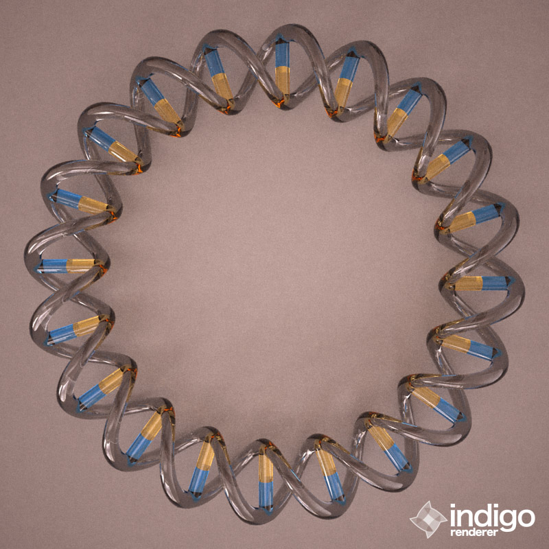

Re: Glass questions again
Set up for blendigo 2.6.1.4
Smaller model = more transparent glass
Nice DAG.
Yields even better results if thelead cystall glass from the matDB is used. http://www.indigorenderer.com/materials/materials/385
I also used a lightprobe from the St. Peters Basilica in Rome.from here
http://ict.debevec.org/~debevec/Probes/
Set the mapping to spherical. You may have to turn your scene upside down because otherwise the lightprobe stands on its head.
You als need to convert the .hdr file into an .exr using for example Picturenaut:
http://www.hdrlabs.com/picturenaut/

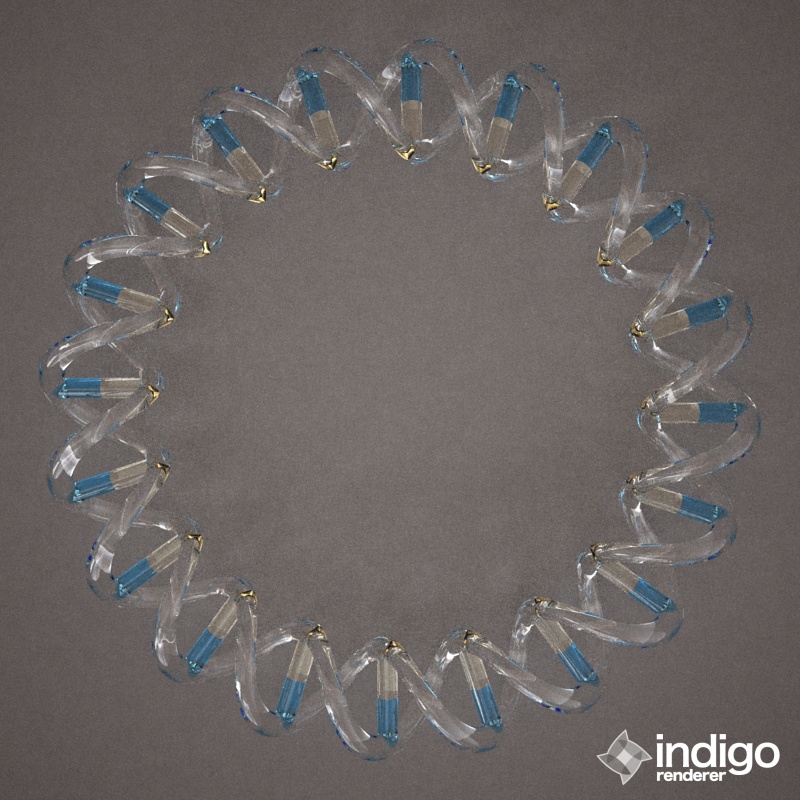

Thanks to everyone that responded. After much trial and error, I now know what I was doing wrong.
1. I wasn't closing both ends of my rods with Extrude+Scale to center+Remove doubles
2. I wasn't using the Edge Split modifier (I didn't even know it existed)
3. I had the 2 'rod halves' touching each other; there should be a tiny gap between the 2
So, if anyone else wants glass beside glass in Indigo (I like caustics), please do the 3 things above, and don't forget to RECALUCLATE NORMALS OUTSIDE with Ctrl+N.
These are more like what I had in mind
Thanks a billion to you all.
scatman
scatman
