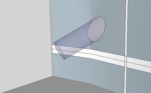

Basically im trying to get an effect similar to the way fiber optics work but with a much wider "wire" if you will. I hope the images below can describe it better for me! :oops:
Before render. The "pole" is going through the wall and im hoping for it to transfer the daylight form outside.
But the light doesnt seem to diffuse very strongly, and the glass is almost invisible.
Any help would be amazing!!
Thanks! :D

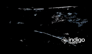

MLT doesnt seem to be a help though... just get this
Yuk!
