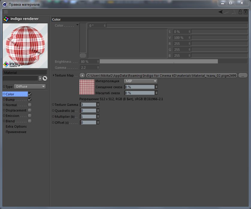

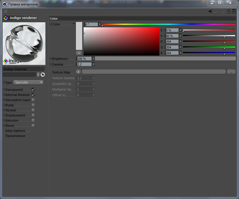

-have the opportunity to sew in the scene settings INDIGO? and under what the parameters working of the standard viewing of materials? I wanted to sew in number of samples render, but not coming out.
-How can illuminate only preview EXR? or for this is to rewrite the connector?

Question. How did you set up your own material preview? Do you have a step by step?

create a scene. cone light all illuminated. save in a folder ...( CINEMA 4D R13\library\materialpreview )... restart Cinema4D check.forgeflow wrote:Question. How did you set up your own material preview? Do you have a step by step?
